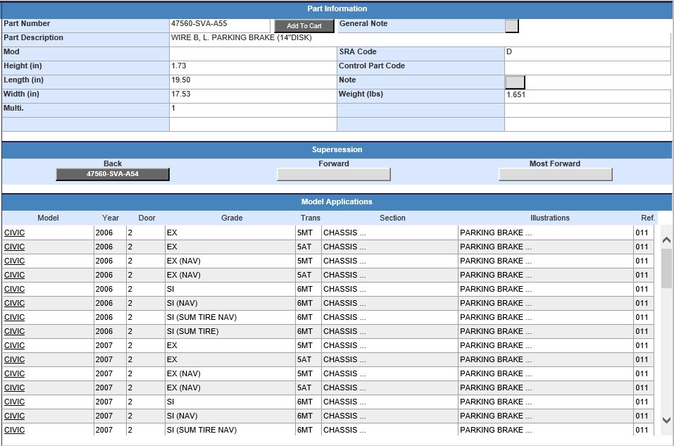

Did a little more searching here on Honda's parts site... It seems as if the 8th Gen Civic coupe w/ rear discs may work in our favor while checking out the size specs. Will post up screen shots of the specs later tonight...

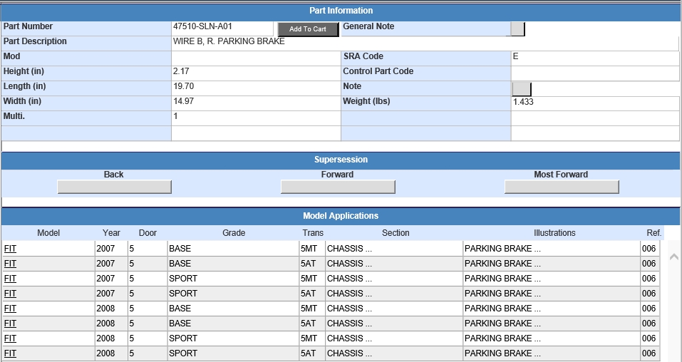

Now to the meat and potatoes... Here in the images below are the specifications via Honda's parts catalog of the left (driver side) parking brake cable on 4 recent model Hondas including our GD3 as a reference.
GD3 Fit - *part number shown is for the right side (47510-SLN-A01) but specs are the same as left (47560-SLN-A01)*.

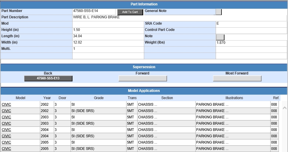

EP3 Civic SI - Earlier in this thread I noted that Fast Brakes may use these cables. I am not a bit skeptical about this due to the dimensions listed from Honda. If an EP3 rolls in at work I will investigate.

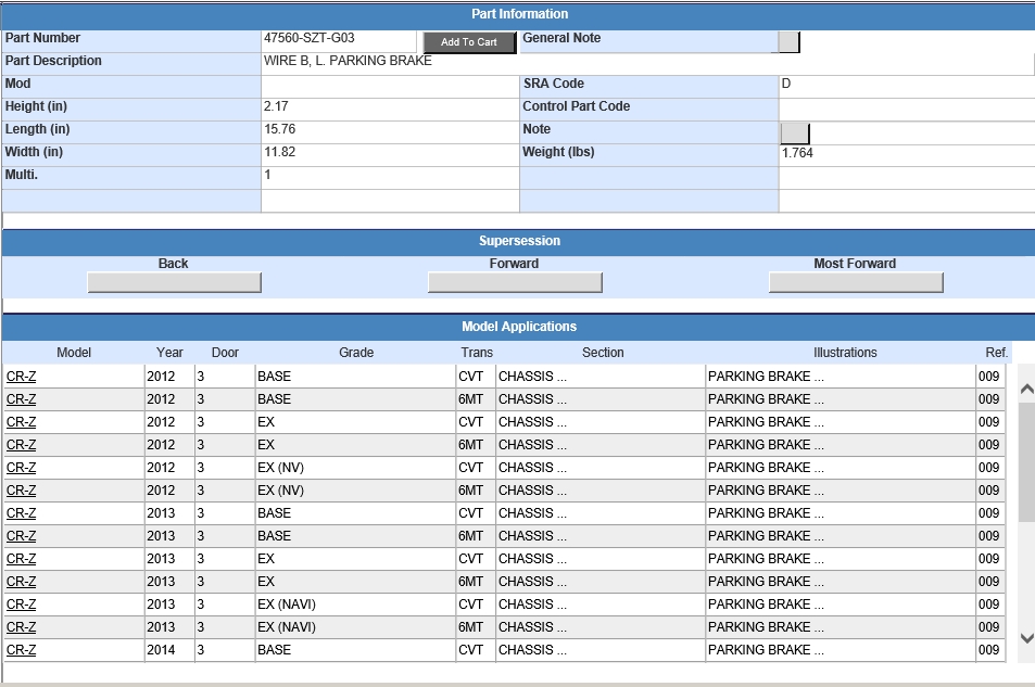

ZF1 CR-Z - This one I was curious about since the CR-Z DOES use the same rear caliper as the Fit in other markets. Going by Honda's specs, these look to be too short.
FG1/FG3 Civic Coupe - Sizing wise this is the CLOSEST I've seen to what we have on the GD3. All of the coupes run the same parking brake cable so it should be fairly easy to source if someone has a You-Pull-It near by and would like to try this.
