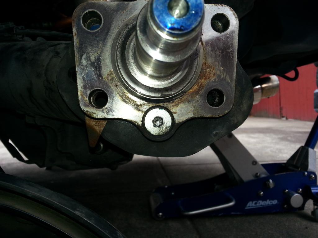

2. on the rear spindle, what is the bottom center allen bolt for if the other four hold the spindle onto the axle?
3. what is the thread size/pitch of the honda fit brake lines at the rear drum? (do the conversion kits simply hook into the very end of the rear brake line or further forward?)
and as a note. it seems the clock that the fastbrakes kit and the ebay brackets put on the caliper is ideal to aid in properly bleeding the rear calipers... the t1r brackets don't place the bleeder valve quite high enough in relation to the piston...

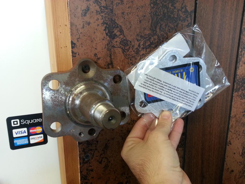

so roughly, price-wise, here's what we're looking at:
-brackets - $100
-rotors - $20
-pads - $30
-reman calipers - $200 (no core refund included)
-parking brake cables - $60
-ss brake lines - $60
APPROX TOTAL = $470
Scott,
We think we will have you handled in 2-3 weeks. We have ordered the parts we need. We will then develop and test. As with our other brackets, we will design for off the shelf parts. We anticipate the brackets will be about $ 100.00.
