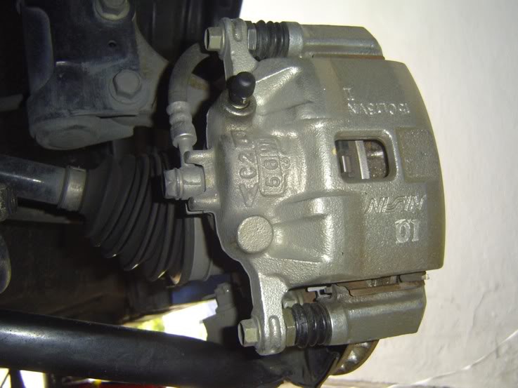

There is a little window on the side of the caliper through which you can see the thickness of the pads. Service limit is 1.6 mm but I don't think I'd let it get that thin.

If you will change the pads, I would go ahead and change the the rotors. It's not worth to have them machined, IMO.
