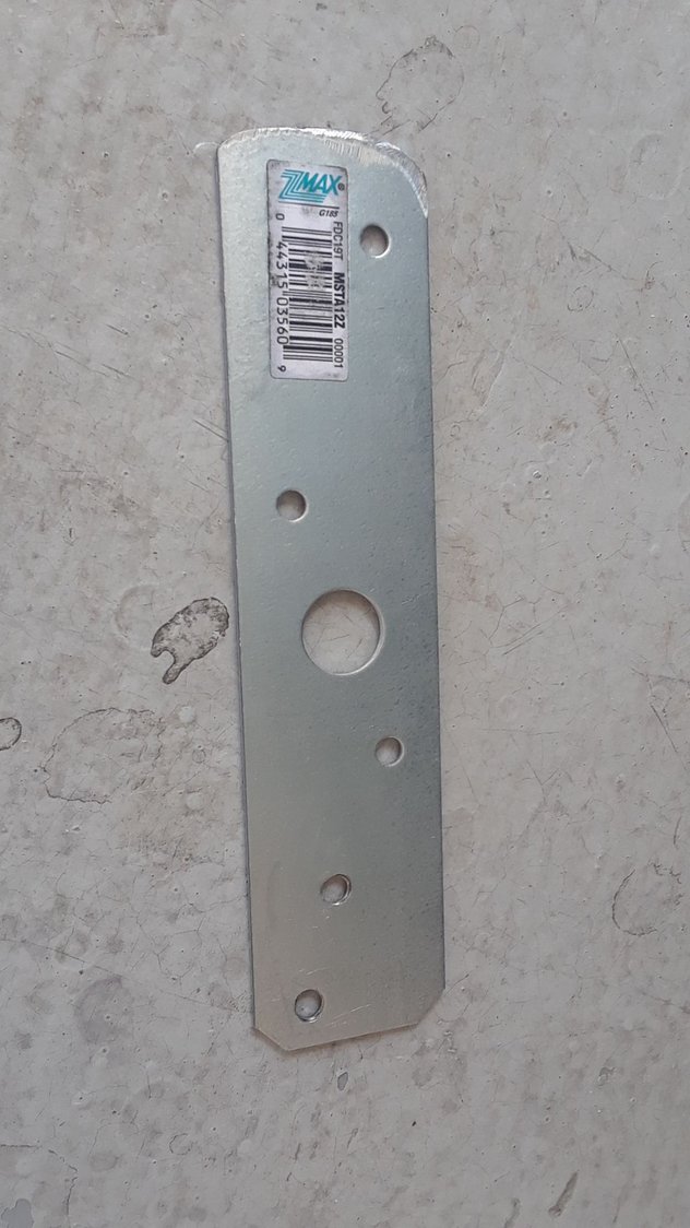

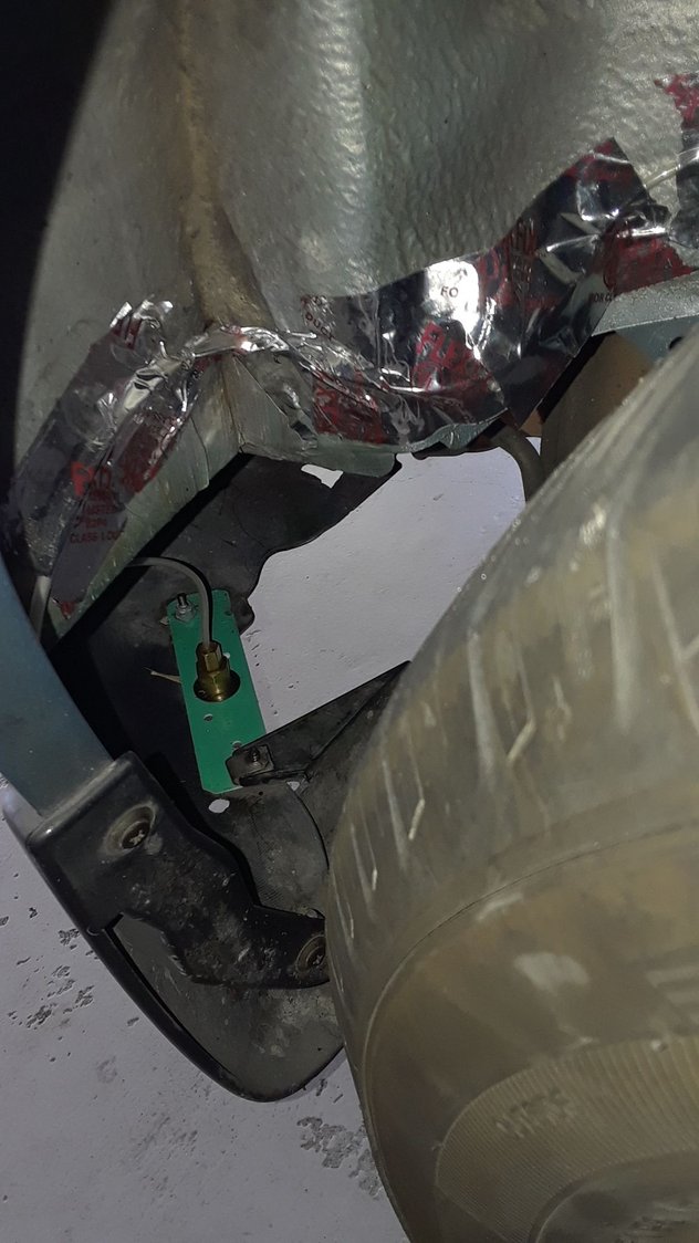

$0.98 strap in Home Depot building suppiles... cut in half.
Bracket painted with primer and installed. Leveraged mud flap screw.

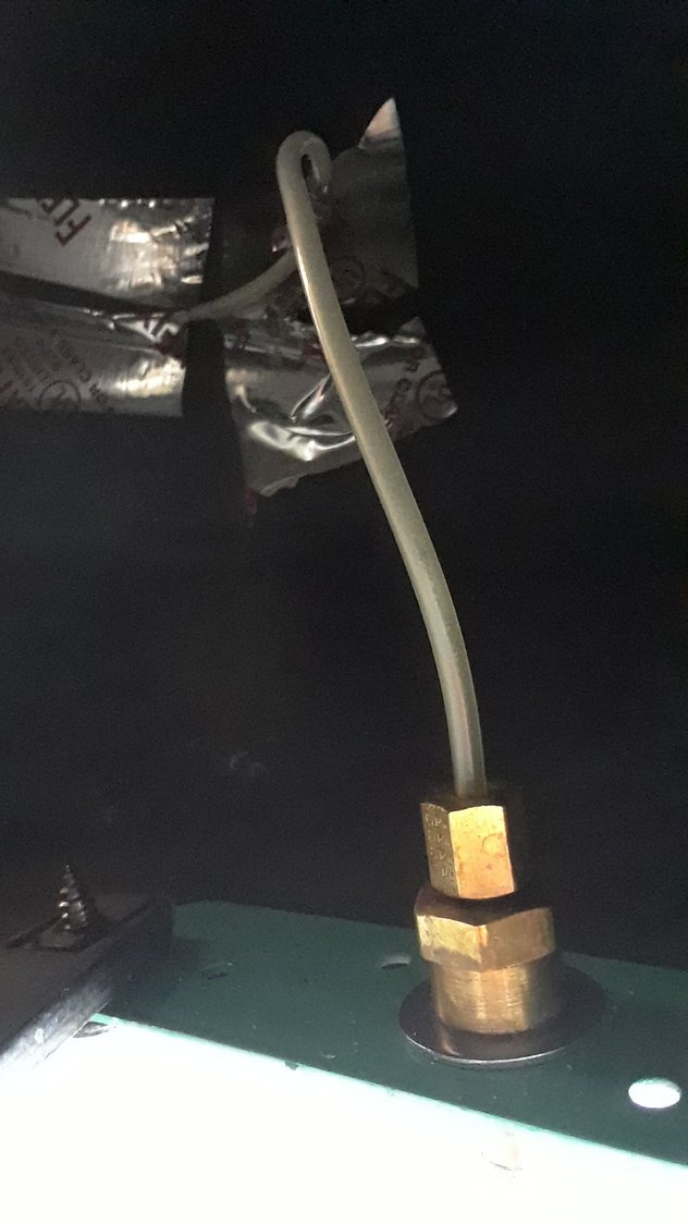

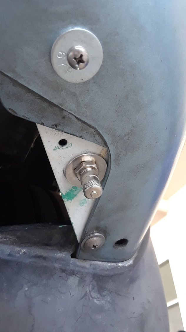

Metal valve fitting installed... one one each side of the bumper per shock.
Inside the bumper... metal valve fitting with air line taped to the bumper.

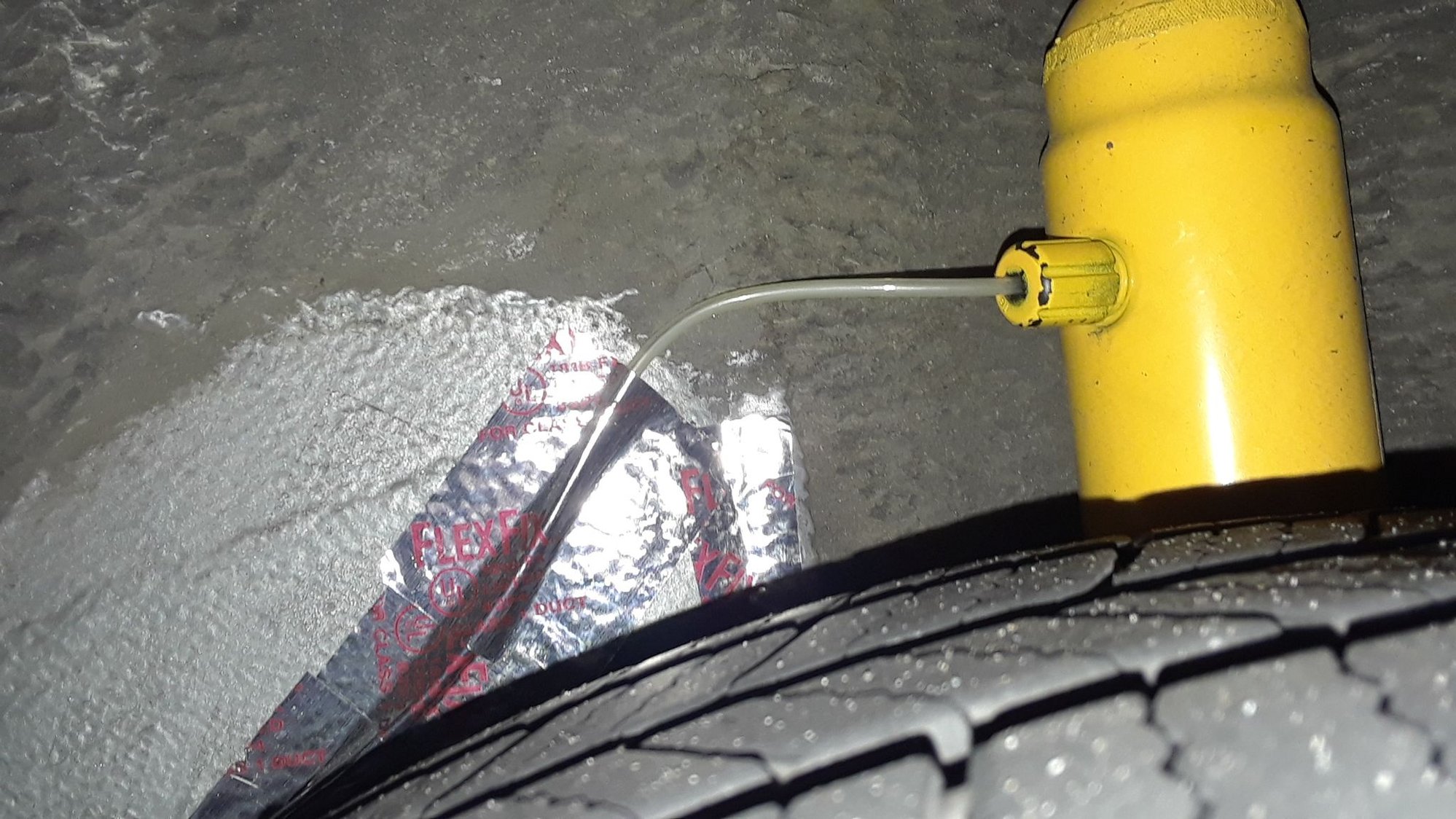

Air line from the shock, taped to the inner wheel well.

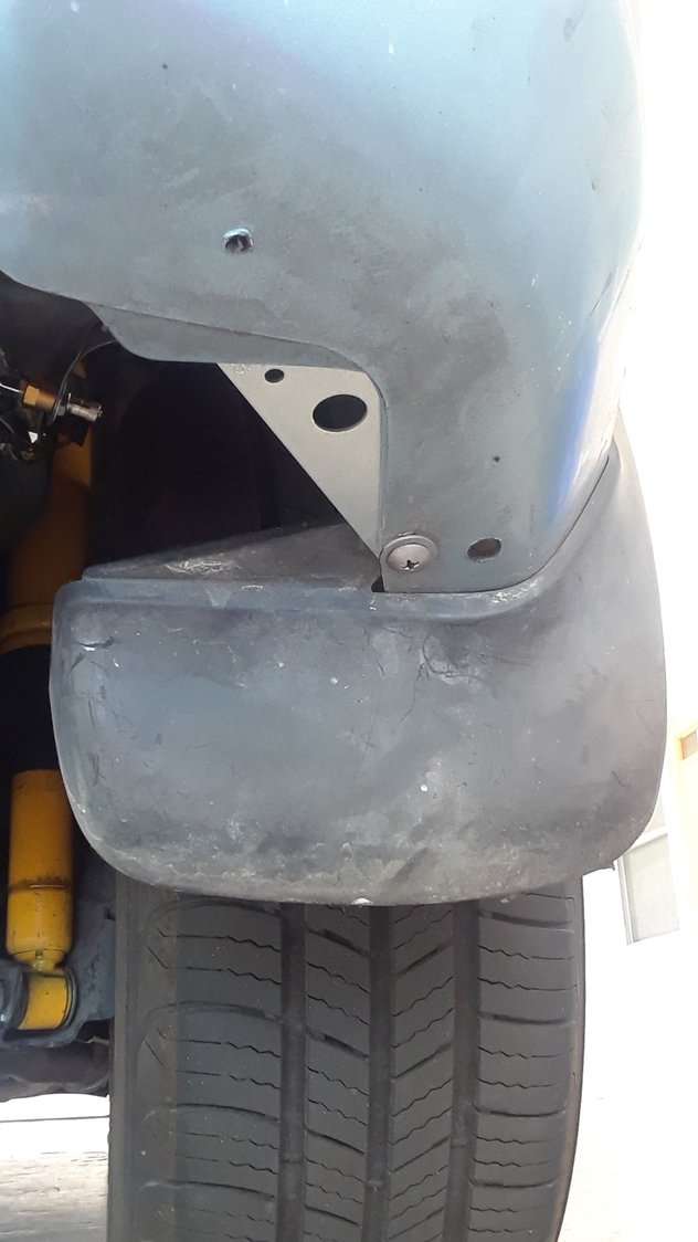

Looking at the ground... airline routing inside the wheel well to the valve fitting.
