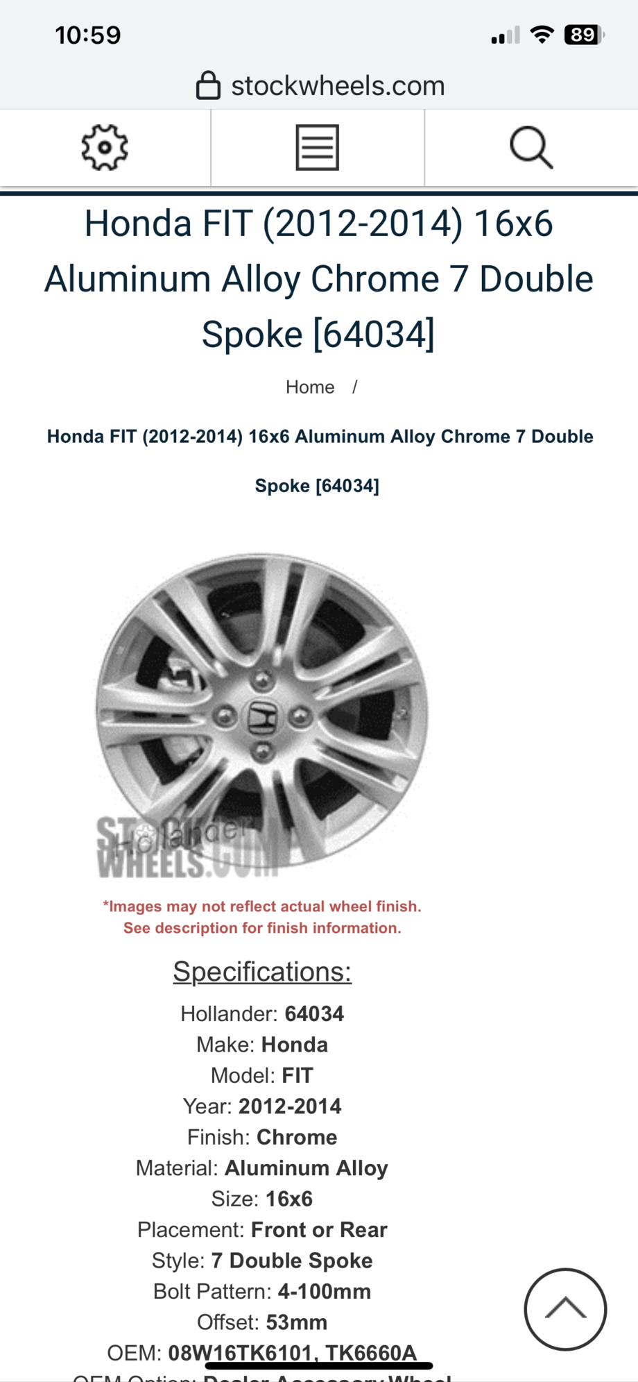

There are several important steps to fitting new wheels. Obviously you need the right bolt pattern and spacing, but just as important is the center bore size which for Honda is 56.1 mm. Smaller won't work (ask me how I know); larger will work with hub centric ring. This is mostly an issue with OEM wheels from different manufacturers (e.g., Toyota <56.1 mm). I think most aftermarket wheels have large center bores so that they fit most cars.
I would have sworn that the offset for the Fit Sport wheels (at least for my 2010) was 53 mm, but I'm not at home and could be remembering wrong.
Here's a good resource to visually compare different wheels/tire sizes to your stock setup (which is a known fit). If you take the additional measurements related to distances to the fender, suspension, etc. you can fine tune your fitment. Regardless, if I was going to buy new wheels I would insist on fitting one to my own car before making the purchase. So far I've only purchased old Civic alloys for snow wheels, but that's exactly what I did and the seller was fine with me doing that in his driveway.

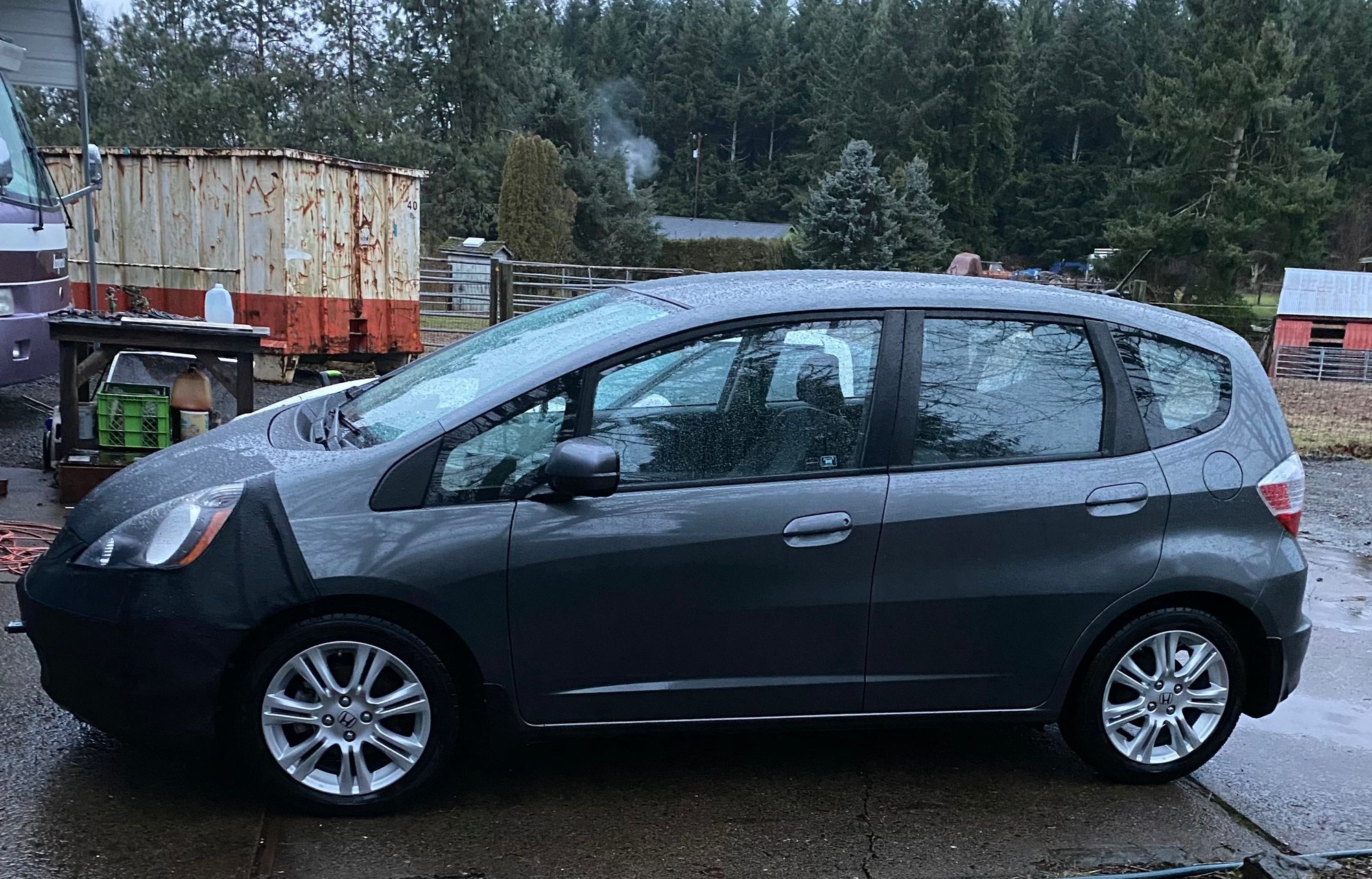

Thank you both for your time and comments. I found someone semi-local today who was quite knowledgeable about Honda and Acura wheels and tires. Turns out he has been in the business for about 30 years. He set me up with these 16 inch Insight wheels and some 90+ percent tread sweet Falkens. Pretty much exactly what I wanted. Refinished some curb rash with DA and paint, mounted balanced with the sensors and lug nuts. It all looks brand new!

Turns out after further research these wheels are…go figure. No wonder I liked em so much. The car handles much better as well although I feel a lot more “road noise”, just makes it feel sportier.
