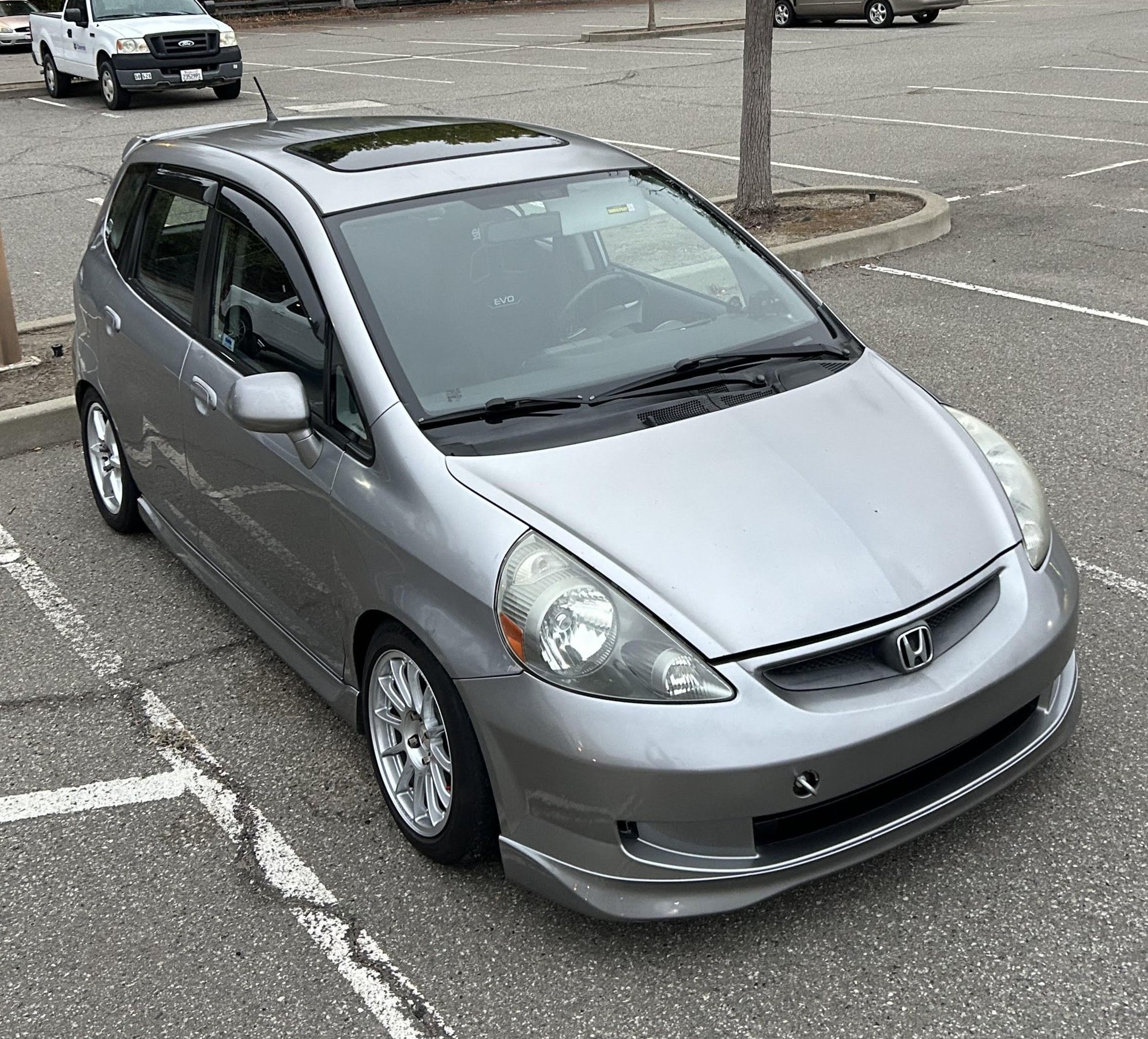

Track fitment questions:
Currently running 15x8+35 front with a 10mm spacer. fitment isn't too aggressive, no poke at 3.5 degrees of camber and rolled fenders without liners. Rear is a 15x7+38, unrolled fenders and it rubs a little. Ride height is about fender to the top of the tire for a reasonable ground clearance.
I'm looking at going up to a 15x9+35 front with a 225/45, and maybe running the 8s in the rear with a 205/50. Does anyone have pics / experience with running either 9s in front or 8s in back?
Heres the 15x8s in front, rears are my narrow buddy club daily wheels
