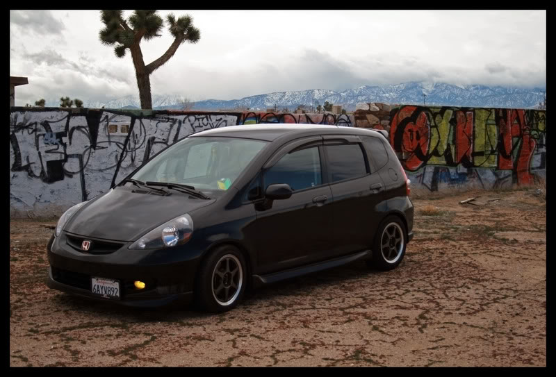

I have 15by7 with 35 offset and rub on dips or fast turns on the rear. Not so much up front.
pic:
