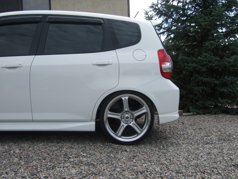

I only have this half car picture, but these are Racing Hart GT5's in an 18"
Car is lowered on df210s, and it was tuckin like half of the tire, lol.
I am pretty sure the tires were 215/35s so that was part of the rubbage also.
Hope this helps!
Dustin

Thanks everyone and thanx for the pic. it looks sick with the tuckage but i dont want it to rub. my bro had 18s on his civic and i had to align the camber to be negative so the tires wouldnt rub the fender. it looked sick and handled awesome. but tires get expensive. so i think ill just get some 17s. i apreciate all your guys help.
