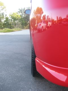

I have a 2008 Fit ,stock suspension with 17x 7 DR6 42mm offset Drag Wheels with Falken 205/40ZR17 tyres with no rubbing whatsoever and I am 6'4 390 lbs so my car does get loaded up

my wheels are a 42mm there is a pic in my profile of my car
