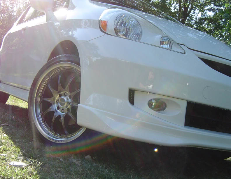

Heres a couple of pics for ya.

We are lowered on df210's, and the wheels are 17x7.5" +42 with 205/40 Falken azenis tires. Front never rubbed, back did slightly til some fender rolling was complete.
Hope this helps!

do you think a 42 offset on a 17 is going to rub any worse than my 38 offset 15, also i am using 195/55/15, and would be using 205/40/17. and im dropped on df210, i have looked in the will it rub or fit section and could not find anything.
wow that was funny, as i was writing this the dude above posted pics of what size i was asking about, same springs too. lol. too cool. thanks for the info dcmcelreath.

The 195/55's equal out to 7.6" wide and 23.4" Overall height
The 205/40's equal out to 8.0" wide and 23.4" Overall height.
The 4 mm difference in offset equals .15", or .0787", compared to the .2" the tire will be closer to the fender well, I would say yes. It will rub worse.
But, as as said, all tires are very different. Whether it is sidewall ply width, or just bowing in the design. I would also just try it. You never know what could happen. Everyone told me that the car would be undrivable with those falkens
Give it a shot, and let us know how it works out!
You are very welcome for the info!

Dustin:
Your car looks very good on this rim. How much did you lower on your df210's?

Originally Posted by TiMo
Dustin:
Thank you, the front is just about 2" lower, and the back was about 1.75"
Dustin

jsensk's Avatar
Posts: 281
From: Houston
Hope this helps!
Dustin
What wheels are these?? Super sweet.
