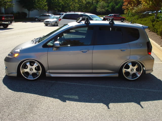

Originally Posted by bradthreee
They wont clear the front caliper without a spacer. The back is fine. And you'll need to stretch the hell out of the tire
They fit. The rear quarter pannels need to be flared. The fronts fit fine. I'm running Toyo TR1's 205/35R18s.
The design of the spokes has more of an impact on whether or not a wheel clears the caliper.
