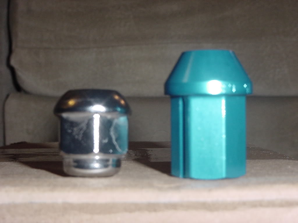

i havent had them on the fit wheels but in the past have used them on other oem honda wheels with no trouble. thew reason you will hear alot of people talking about how it is a total no no is because all oem honda wheels use a ball seat style lug nut, and most if not all aftermarket wheels use tapered style lug nuts. it basically breaks down to, after market lugs dont have as much contact on the actual oem wheel surface because of the different style seat. i would say go for it if yo uare just driving to the groceries and to work but steer clear of this if you run the canyons hard everyday like my self.
here is a picture comparing an oem lug nut (on the left) to a tapered after market lug nut (on the right)

I forgot to update this before but the auto shop couldnt get the tuner lugs to fit. They are too skinny. So... back to the old ones.
