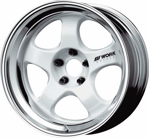

Hey here are the wheels i want to get
The size is 16x7 4x100 +40mm offset 67.1mm bore would these fit on a lowered fit with progress springs??? I'm not sure i might get them in white but i love the gunmetal. And if any one is good with editing could u put those on my car so i can see how it would look thanks guys

No sure i can't find where ir says any where. But guessing 3 inches. They are knock offs of these if u ask me but i can't afford these at $400 a rim. Well those are only costing me less than $500 for a setName:  152.jpg

Dam i just called JLB that is who i am geting them threw they don't have the gunmetal or white in the D2 but they do have black and silver. They say the black is a gloss and looks just like the pic i have. So should i opt for those guys what do u think?? I really need some one to photo shop those on my car if they look good i will buy tonight
