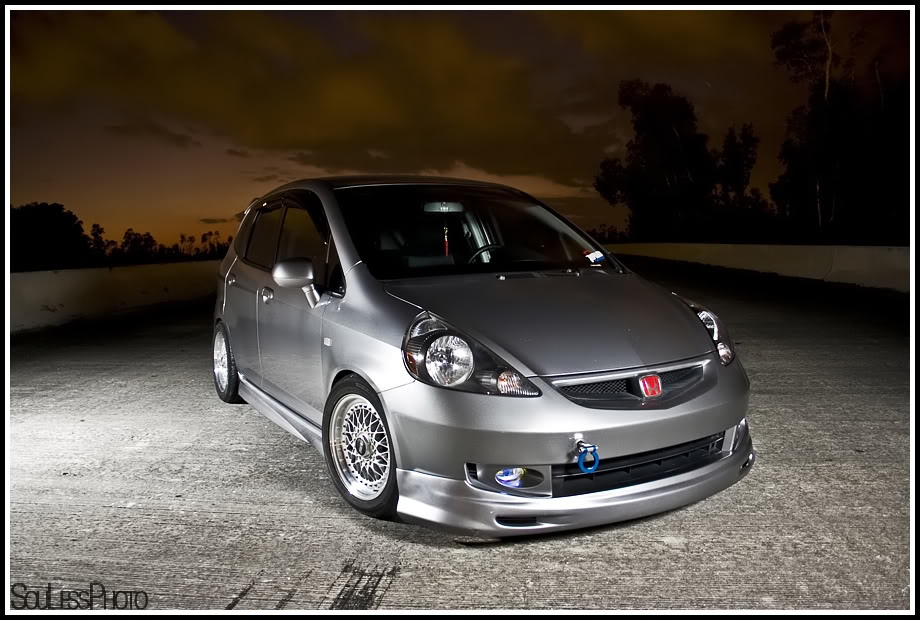

and here is a picture before he painted them and got the bigger lips:

nice car :P Sorry if don't understand everything you write im french. :P

here is a teaser of his BBS's
that is bad ass, I want more pics!!!
yeah his fitment is so nice.
that's the only pic he's "released"
he's getting quality ones soon
