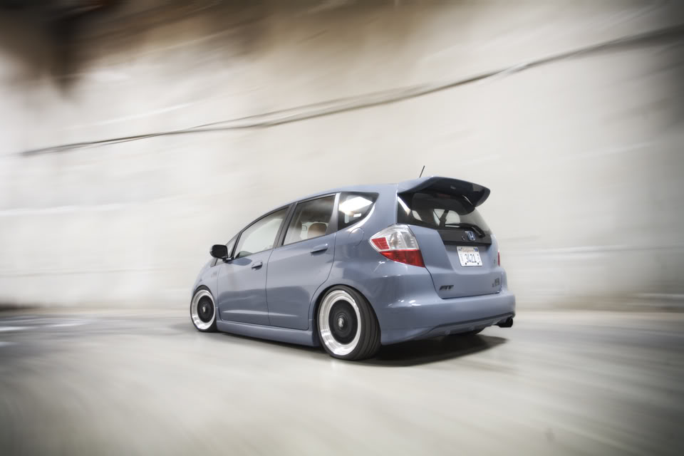

how BBS's should be done on a GE
sorry i've posted this picture so many times, i just LOVE it

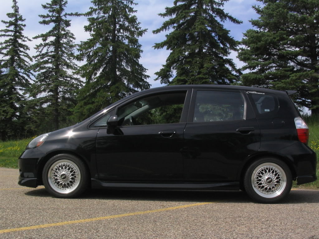

Id say go 16"s, 15"s might look to small on a 09. Here is some 15"s on my Fit
Old Feb 11, 2009 | 10:14 AM
xmathx's Avatar
Posts: 30
From: Hull,Québec
Thx for the picture sweet ride How much is the offset on those wheels ?
Do you have 205x50x15 or 195x50x15 ?
Thx for all the help
Old Feb 11, 2009 | 10:24 AM
MNfit's Avatar
Posts: 3,380
the offset on those wheels are 38mm with a 195/50/15. One of these days im going to get all new hardware and a 1inch lip to rebuild the rims.

towelie = eriel.
here is a teaser of his BBS's
