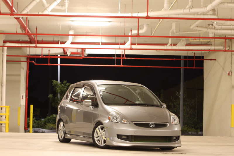

here is my car you think ill have a problem?
ps: I got spacers all around
