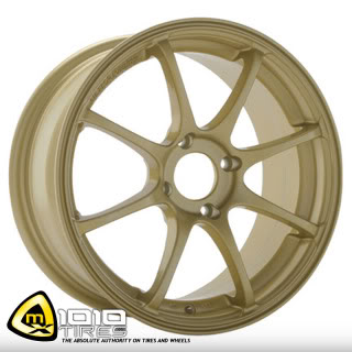

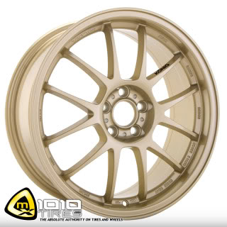

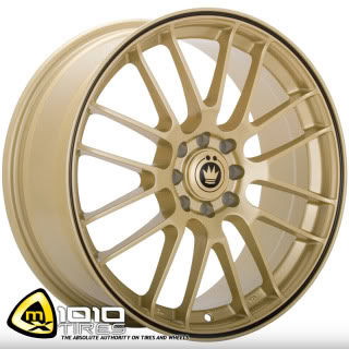

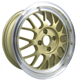

Does anyone have real pictures of these rims? I'd like to see the level of intensity of the gold color.
All Konigs - Daylite | Feather | Twilite
SuperMesh?
SuperMesh?
