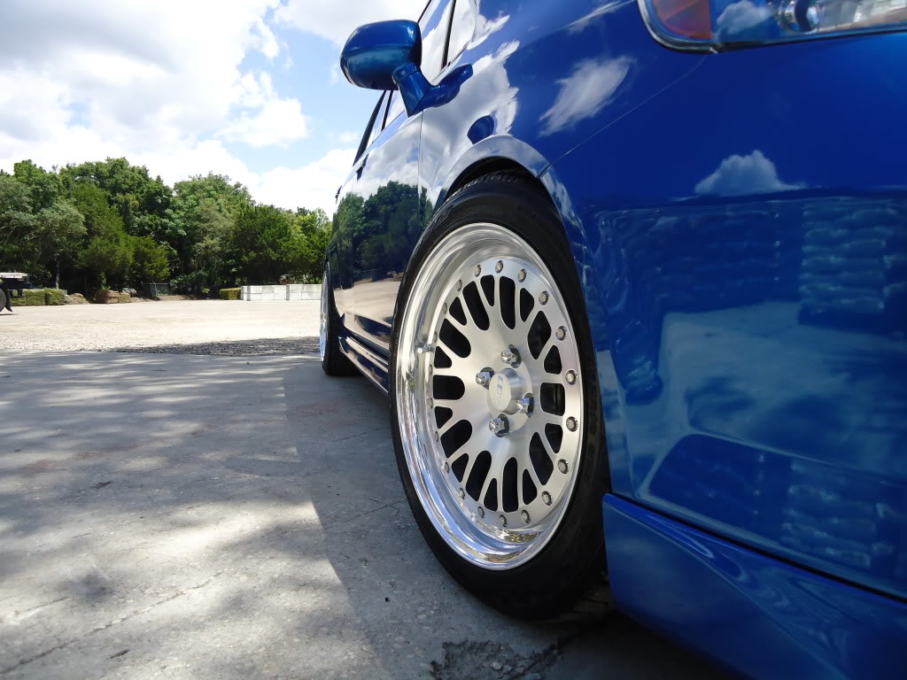

Not my car but because I love the wheels I had to post it up.
The car belongs to 1_Bad_Fit90
Front:
16x8 +29
205/45
Rear:
16x8.5 +29
205/45
Mods Required: None (From what I can see since the fender doesn't touch the tires)

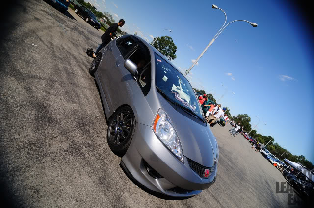

GE8
Front:
16x7 +40 for now will be 16x8 +25
185/55
Rear:
16x8.5 +12
185/55
Mods required: None

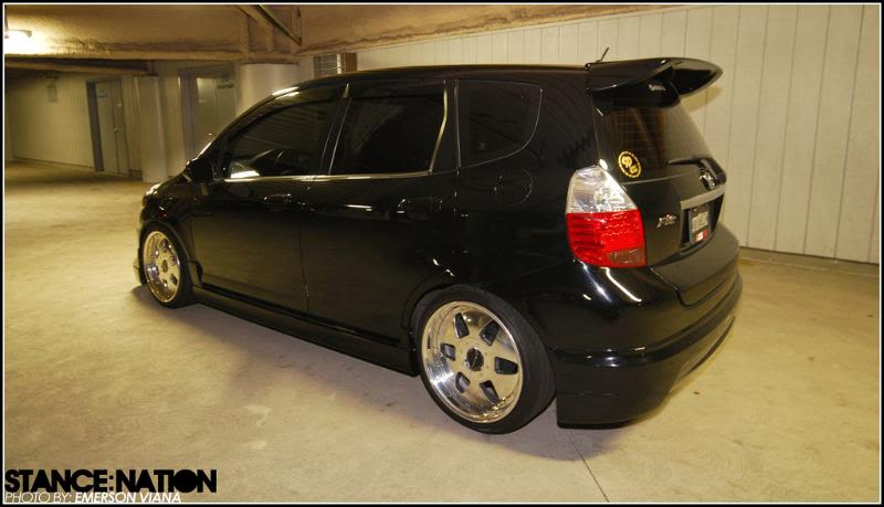

Old Jun 27, 2010 | 07:55 PM
Fit4Trav's Avatar
Posts: 3,860
From: Chino, Ca
SSR Vienna
17x7.5 +30 +24

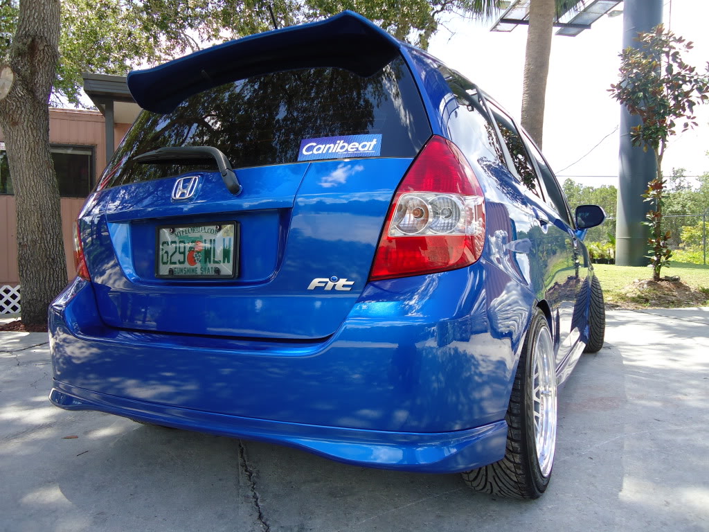

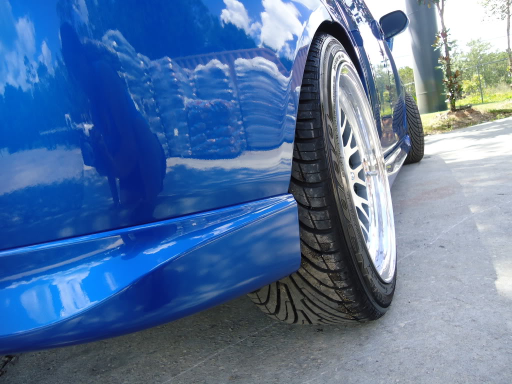

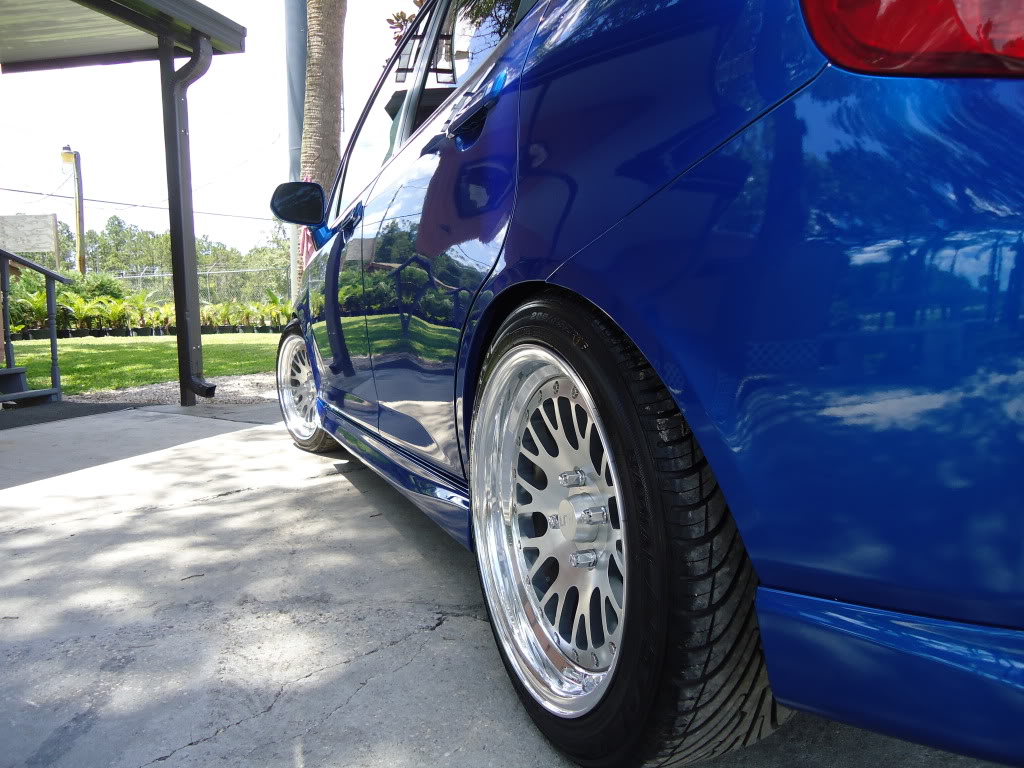

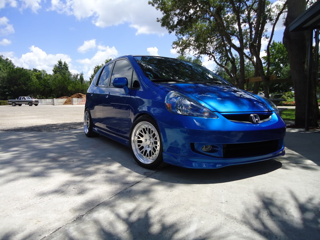

thanks for posting my car ;]
as for mods: fender rolling and cutting was required and camber kit as well. it still rubs a bit now, but im getting new tires 195/40/16 [more stretch]
here's a few more pics. hopefully everyone likes my car!!
