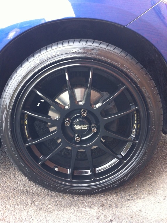

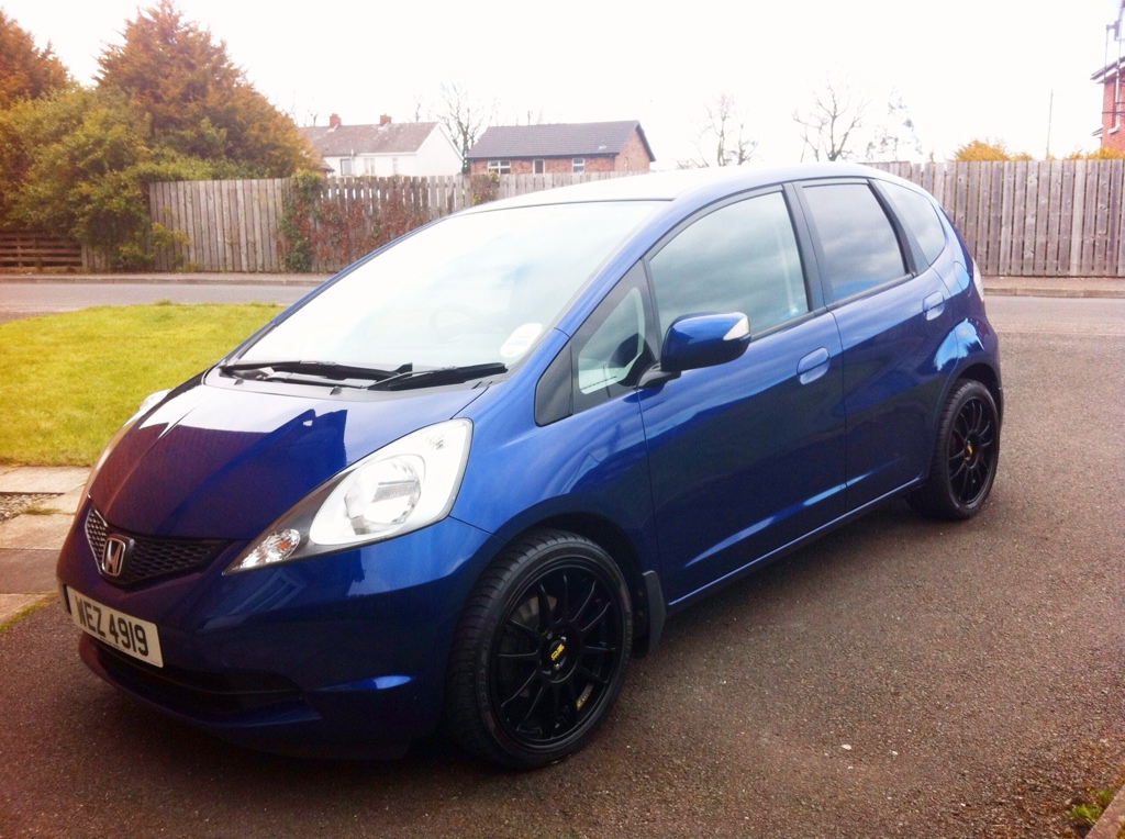

Ive 17x7 OZ Superleggera 37 offset running goodyear F1 GSD3 195/45/17
No rubbing and tyres sit fine on rear and flush on the front. These tires are the correct ones to give the same rolling diameter as OEM. I ran 205/40/17 for a while but fuel consumption was about 4mpg worse!
