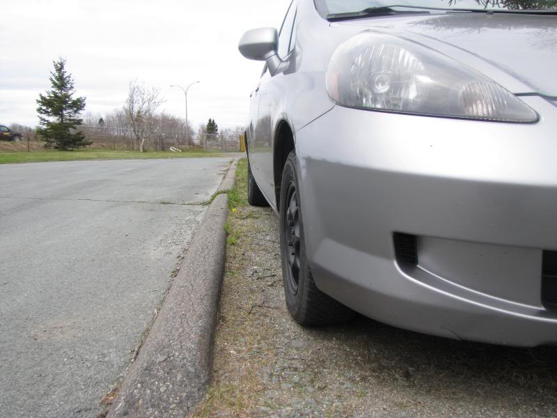

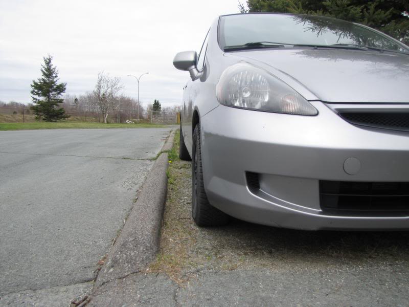

Here is the stance before and after with the 25 mm spacer on each corner:
As you may notice the spacers will save you some grinding which is probably a few hours of work. To get them to fit without spacers was about 16 hours of grinding in total... :-O

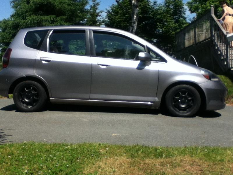

T1R Springs (1.6" F 1.4" R) on 175/60r13 tires (drops another 0.7" compared to stock 195/55r15).
Sometime I'll get my function and form type 2s installed and will drop it more to narrow the fender gap.
This is friggin' awesome! Very nice!
