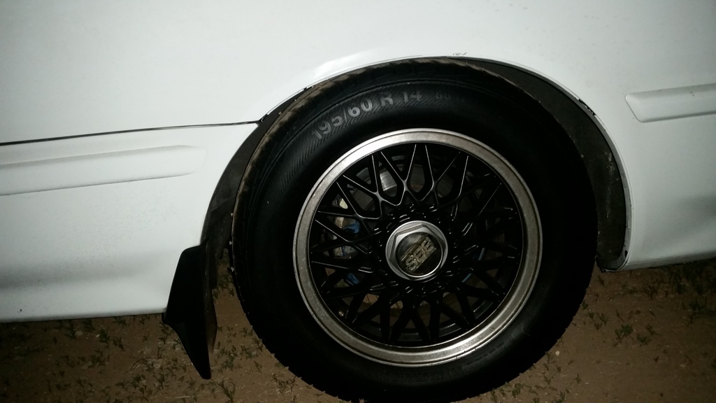

The tires on them are 195/60/14
and they are from the e30...Called BBS mesh...
This is the add..
For sale asking $250obo bbs mesh wheels size 14 with 70%+ thread on tires missing 2 center caps

The wheels should clear the brake calipers no problem. Depending on face design you may or may not hit the front of the calipers with the back of the wheel, but nothing some 5mm spacers wouldn't fix if you absolutely had to. It may be fine. The tires are a pretty small in diameter though.
Too bad you're not closer I'd take the tires for my other car lol

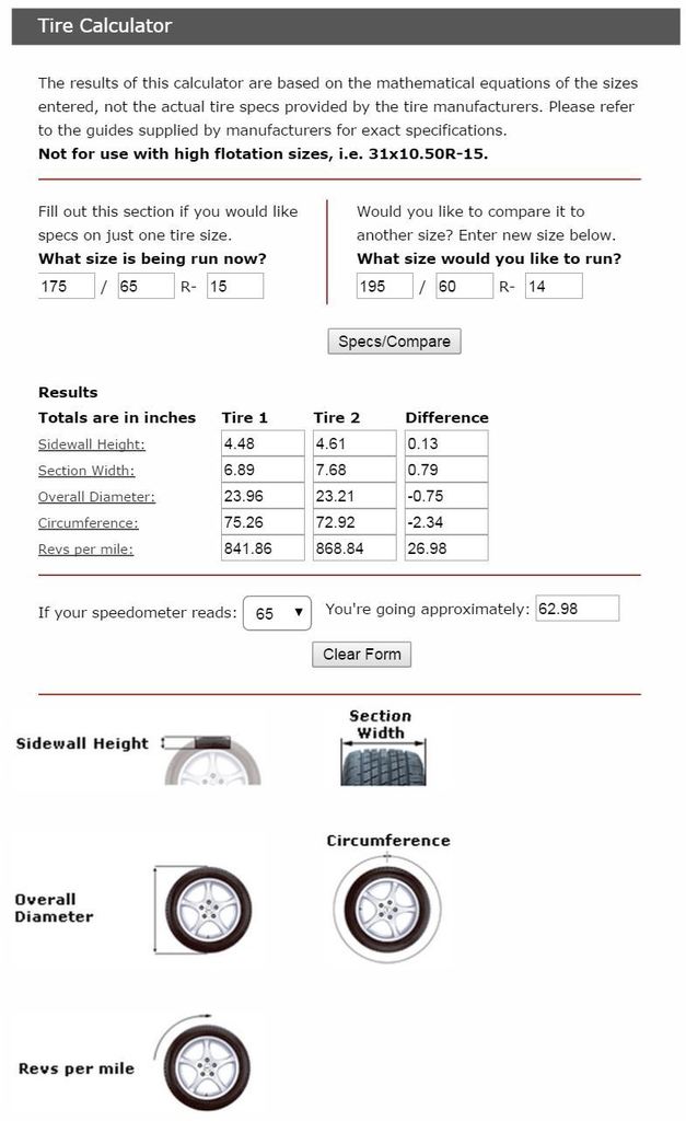

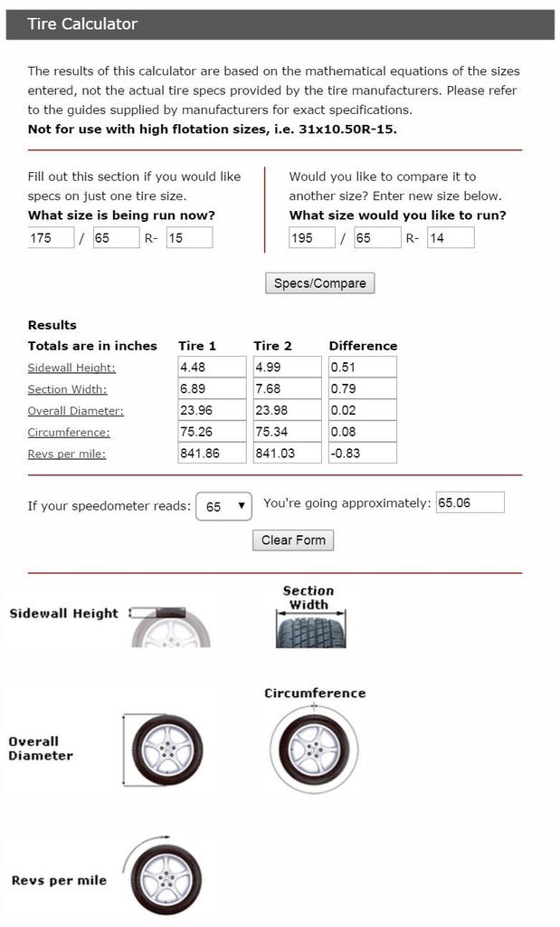

tires are a bit small, your originals 175/65-15 and if you are going down to 14" really want 195/65-14 but 195/60-14 your speedo will be a little off
what's the rim width and offset?
using 195/60-14

using 195/65-14
