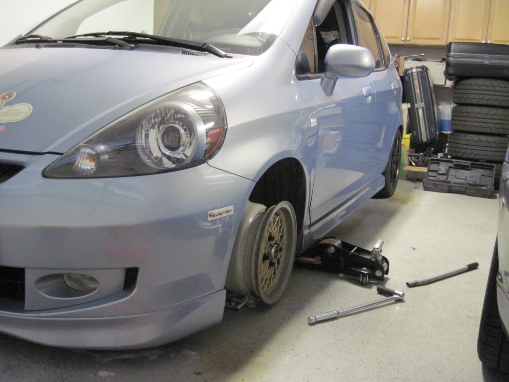

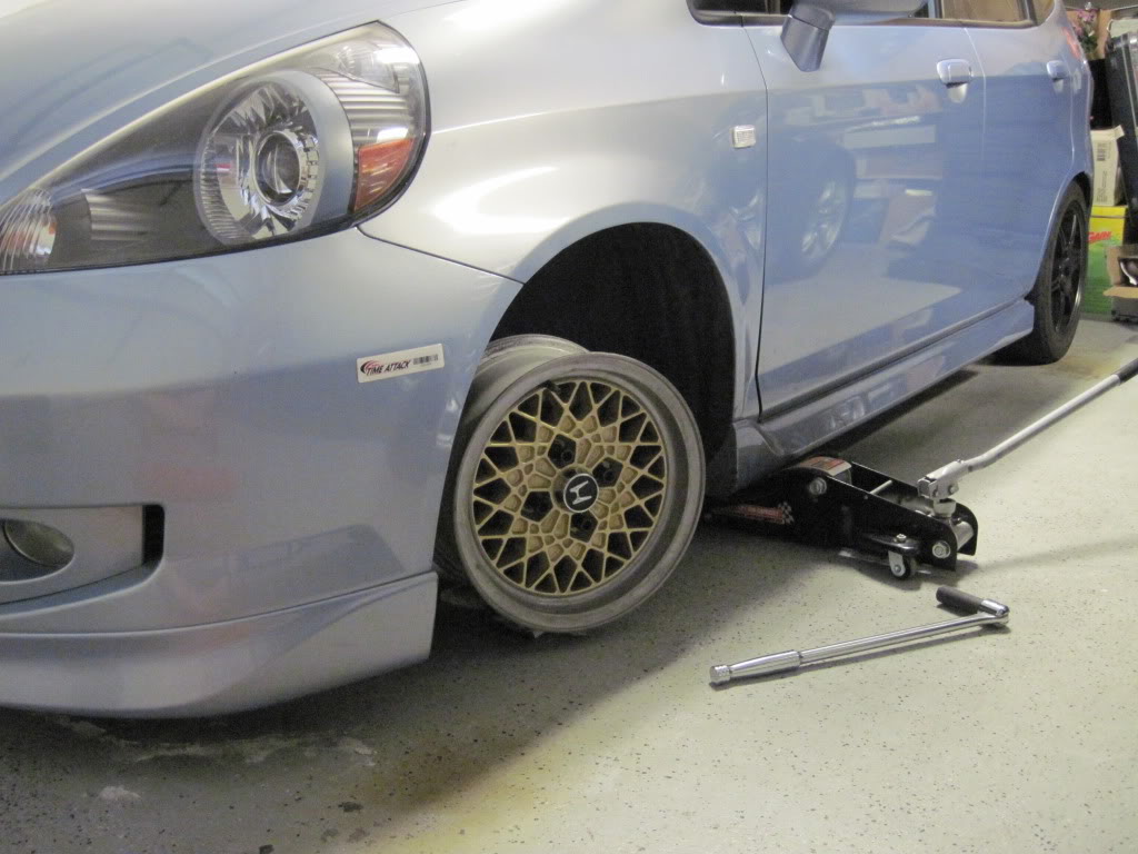

I would have to shave down my brakes just a tad if I get them... Also, it seems like I might need hub-centric rings, it's hard to center them manually. No idea on the exact specs or even what they are.. But all I know is they're 13x6 or 6.5, unknown offset. The only names I spotted across them were VIAL and a torn up RONAL sticker.

what tires would I get for them anyway???

Whats the clearance between the inner cylinder and the calipers?

ummm... I don't know. I cant see inside to even know where it's rubbing. Not enough space for light to go through or feel around. hahaha

Put painters tape on either the brake caliper or the inside of the wheel. It'll tear away where the wheel rubs.
As far as the tire sizes, try going to the link below in this post, key in your tire sizes and click "Show Tires Made In Each Size". Hopefully that'll help you find a set of tires that will work for you.
Tire Size Calculator - tire & wheel plus sizing

205/65/13 would work
