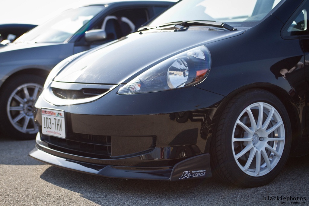

This is my old car/its fitment.

Looks damn good man! Might have to check those out

That looks so good. The lip, the grill, the wheels.

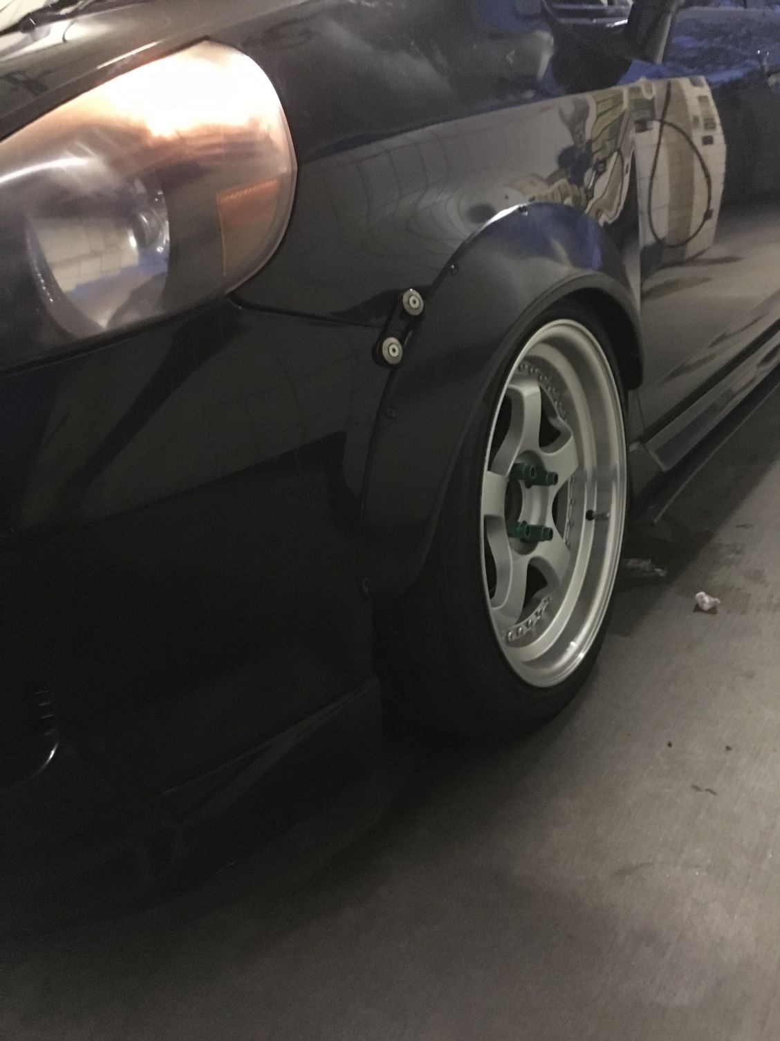

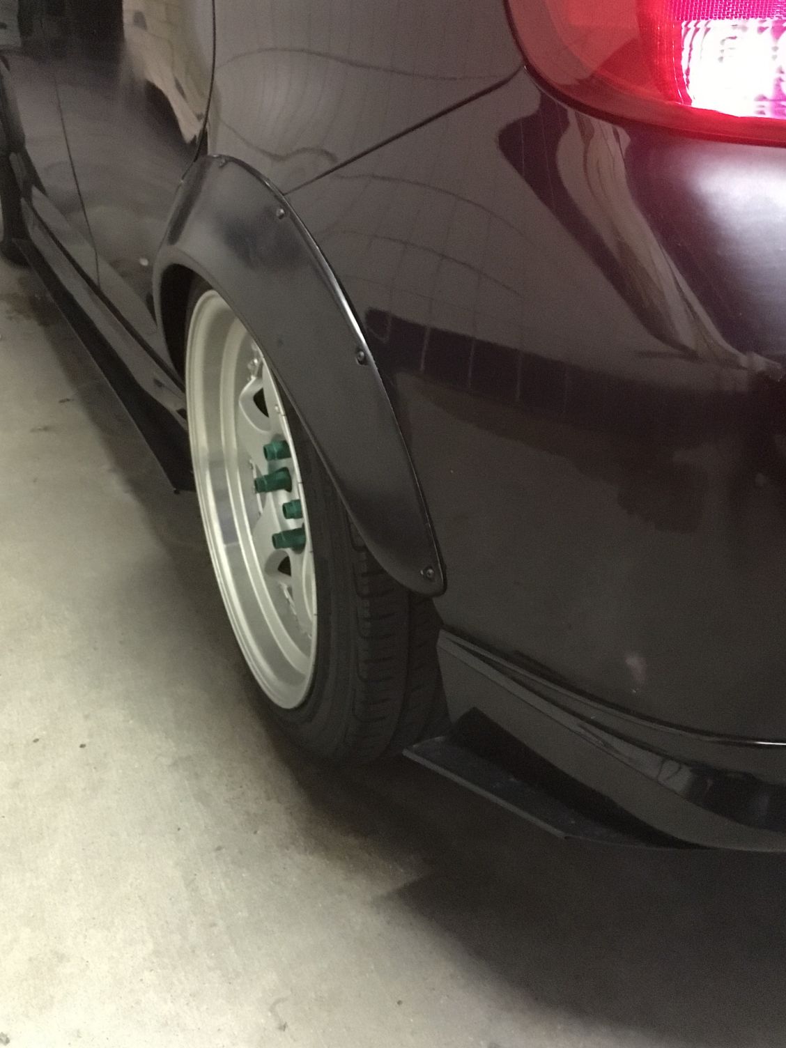

This 18x8 +20 offset. Don't know about 15" but you'll need to pull, roll and cut the rear tab off. Fender flares were done today. Plus, I believe +20 off set sits flush with own fenders. I know mines look off right now but I'll put some 56.1 1 or 1 1/2 wheel adapters.

Why would bolt on over fenders that don't fit the car visually...at all; for wheels that don't need them even a little bit?
Ugh.

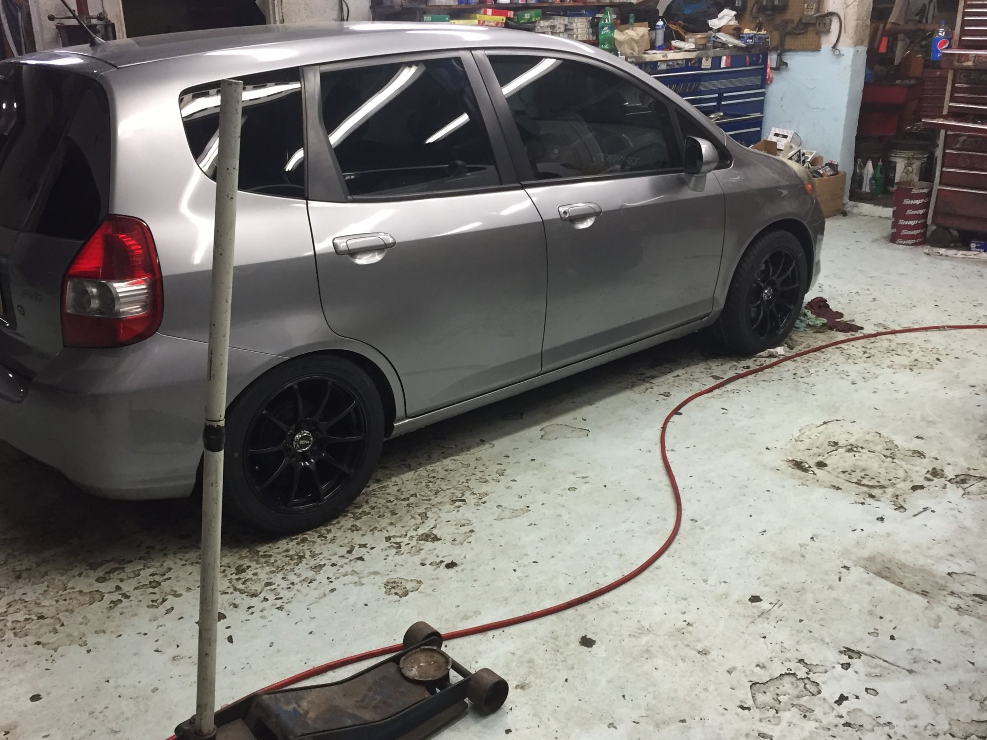

16x7, 40 offset, 205/45/16, I had to roll the rear
