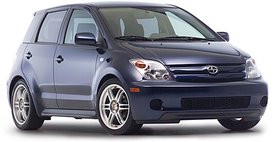

The lighter the rims the better the car can accelerate and the faster you can stop. This applies for any rim size. Light is good. But lightweight is expensive when carried to the extreme as some rims are as low as 9 or 10 pounds.
For the smallest affordable and light rim-
14x6" Kosei K1 TS +38mm offset 9.3 pounds each grey or silver painted
Gravity cast Shot peened $119 each
Fits tires 175/65-14 or
185/60-14 (good size)- Yokohama AVS ES100 $72 each (summer tire) or Bridgestone Potenza RE960AS Pole Position $65 each (all season)
Silver finish
(Pardon the xA)
