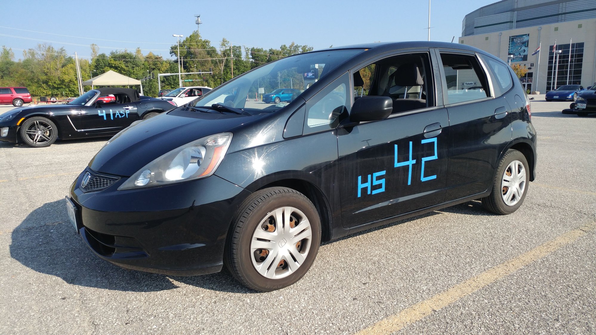

Thanks for the suggestions everyone! I honestly don't care if they're ugly lol, I just want something light, and wide enough that I have tire options. I didn't realize I could get a set of used RPF1's that cheaply, that looks like a great option. Only thing is the tires I'm wanting (Bridgestone RE71R) don't come in anything narrower than a 195, but that should squeeze onto a 7" without any real problem shouldn't it? Or should I try to find something in a 7.5?

195's are generally used on 6 or 6.5" wheels. Our factory GD sport wheels came with 195's on 6" wheels.
I'm currently running a 205 on a 7" wheel and it's still fairly stretched.
What model Fit do you have?

2010 GE8 base. Am I doing my math wrong? 195 mm is 7.67 inches, but I admit I don't really understand the specifics of how tire sizes correlate with wheel widths (why is one in metric and one in SAE? whyyyy must it be so complicated lol) <_<

Bridgestone recommends a 5.5"-7" wheel for the 195/50/15 RE-71R. For the 205/50/15 RE-71R the recommended rim width range is 5.5"-7.5" with a measured width of 6.5" and tread width of 7". Personally, I'd go with the 205 wide tire on a 7" wide wheel. Not sure why you want narrower tire?
Look at the specs page in the link below and you will see what Bridgestone recommends for rim with for each tire size. Some of it is related to sidewall hight.

Mine's a base model, they came with 15s. Suitability for autocross is my main consideration, so I think 205/50-15s on a 15x7 is what I'll go with. Thanks!
