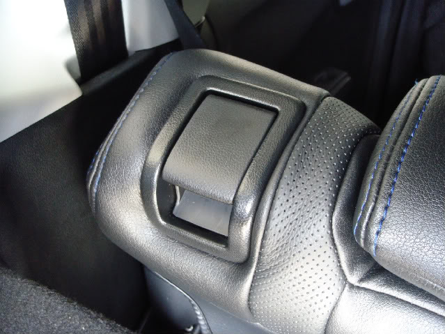

Originally Posted by justintime
The cover is cut as a hole around the latches. Its the only part of the entire set that I thought did not live up to the overall quality... at least some stitching there would have been nice. I feel it just *may* rip eventually. Let's hope not.
I used a phillips screwdriver to loosen the latch assembly and squeeze the cover under. Similar process as the headrest holes but you have to undo the latch.
Thank you. I will check for those screws. When it warms up. It is cold here today.

Thank you aenokeaI did my latches today. For those of you that can't find the screw do this. Hold the latch up and look underneath it. Voila. Take the screw out all the way. Be caerful though not to drop it in the hole. Then a good tug on the latch will pull it out of the hole along with the surrounding trim piece. There is a cable on it. Now just centre the material under the latch assembly as you likely do not have the seat cover 100% over the hole. When centred push the assembly back into hole trapping the edges of the material and re-insert the screw and tighten. All done.
Boy does it look like these are the original seat coverings and not material. Nice!!

<SLAPS OWN FOREHEAD> Why didn't I think of that?! Thanks! Love these forums!
