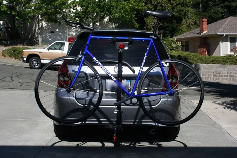

i mean when driving there is a very noticable movement in the rack.

It looks like a solid setup, do you mean side to side or back and forth when you accelerate?

have you driven with the bikes on the rack? is there any clanking? like play between the hitch and rack?

You know I was expecting there would be with the tolerances between the two components. But I noticed after I started threading in the bolt it sucked the adapter right over to the left side of the receiver. Inside the adapter is a totally solid and threaded block of steel.
After I really tightened up the bolt with a ratchet there is no movement at all. You can move the whole car around and it is totally solid. I think if it was just a pin then it would still move around.

see, mine is just a pin connecting the hitch and rack. that is probably the issue. i gotta take a look at it tomorrow. throw a bolt on there

If you can get a bolt inside the adapter it would tighten up to one side similar to mine. If you put it on the outside of the receiver there would still be some play in it.

yeah thanks. i'll try to figure something out with this rack lol. maybe just glue some washers to one side lol. idk. rep for you
