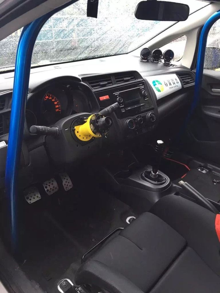

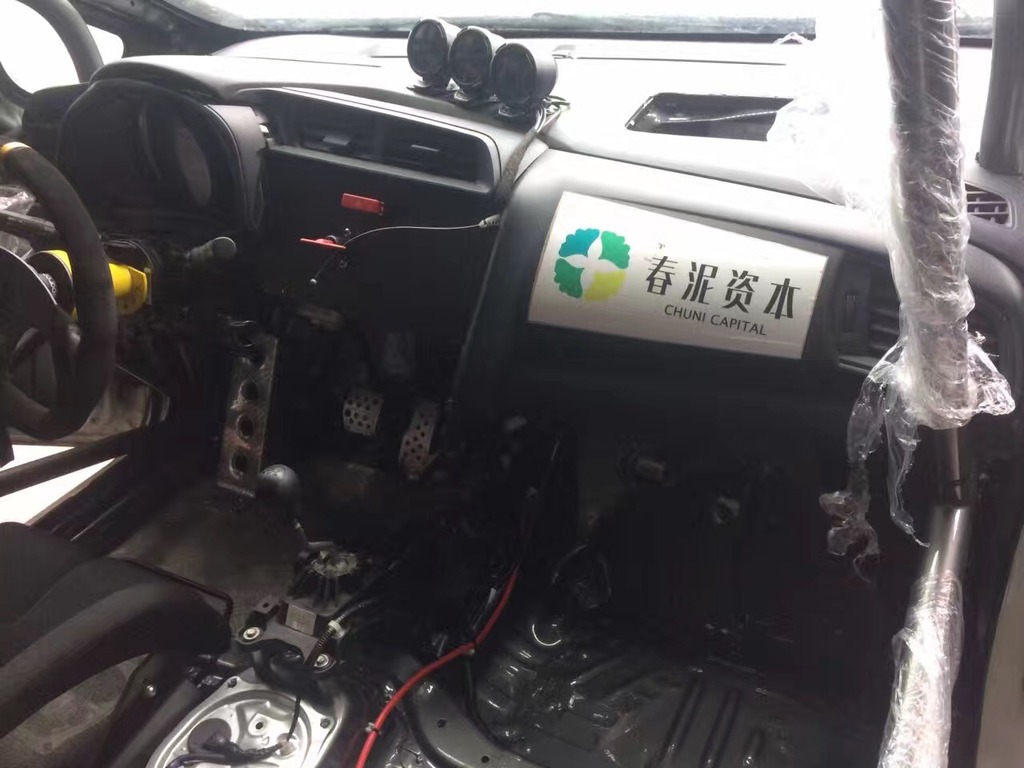

Originally Posted by x_25
Does it change the height of the shift knob? I would like it a little higher, but with a shorter throw.
Does not change the height. Raising the shift know height and reducing the throw work against each other. Two ways to deal with this:
1. reduce the throw with a proper short shifter like the buddyclub unit where it is an entirely new shifting mechanism and then extended the shift know with either an extension bar or an extended shift knob. Here is a photo of being done this way.
2. Raise the entire shifting mechanism with custom made spacers below the shifting mechanism therefore raising the entire shifting mechanism up higher. You can only do this if you remove the interior of course. Here's a photo showing it being done this way.

Tha ks for the reply. I was more asking if it was a true short shifter or a "short shifter". Sounds like it is a true one. That and some spacers would get the job done. I will be looking into it.
