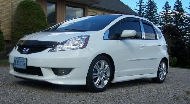

Black3sr's Avatar
Posts: 4,250
From: Kitchener,Ont Canada
Yes lowered = rough ride. I put up with it for the look.
With GE Swifts I did not need to cut bump stops.
