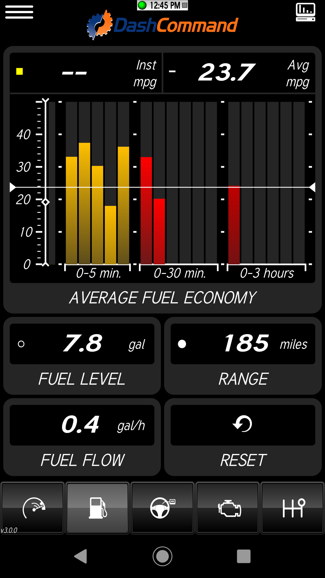

So the MAP sensor arrived and i dropped it in. I wasn't very optimistic but my milage immediately started to rise! PROBLEM SOLVED! I wish i would have started with the MAP sensor. I peeked in the old one and saw shiny black debris/fouling. When i get a chance I'll cut it open and see what's up.
While everyone's car will have a unique set of issues, i would highly recommend starting with the MAP sensor for anyone having low milage issues, as that was, without a doubt, the main culprit in my case.
The screw holding the MAP sensor was stuck, however, and broke several hardened Phillips bits on my impactor. Couldn't torch it because the sensor and upper throttle body are plastic. A solid "tap" with a hammer on the back of a screwdriver did the trick to loosen the screw.
Fwiw, i was getting ~27kPa pressure at idle (with engine fully warmed up) before changing out the MAP sensor. After i was getting ~38kPa.
I should mention that i have a washable k&m air filter that i installed at the first oil change. I didn't realize i was supposed to oil it after cleaning it until recently. Oops. i do expose my car to a lot of dusty environments: landfill, off-road on dirt roads hunting, beach driving, etc. The car has also lived outside for 13 years in a high humidity climate. Not sure if that has much to do with a bad MAP sensor, but just sayin'.
The other things that i did all helped to restore performance, but had minimal impact on improving mileage. One thing i left out in the original post was that i cleaned the EGR a few months ago. That didn't help either. Now maybe i wouldn't be getting the miles I'm getting now had i not done all those other things, but definitely the MAP sensor is what i would have started with if i were to do it all over again. I certainly don't regret doing the tune-up.
One last bit of advice is that if you plan to change the PCV, do it when you do the valves while you have the upper intake manifold removed. You'll have to pull the lower intake manifold too, but everything else will already be out of the way. i was going to change mine but just realized where it was. Problem solved, so just going to return it to amazon.
Here's a screenshot of me hitting over 30mpg in city/suburban driving (for the first time in years) after a $17 one-screw fix. Can't wait to take her on the highway! Woohoo!
