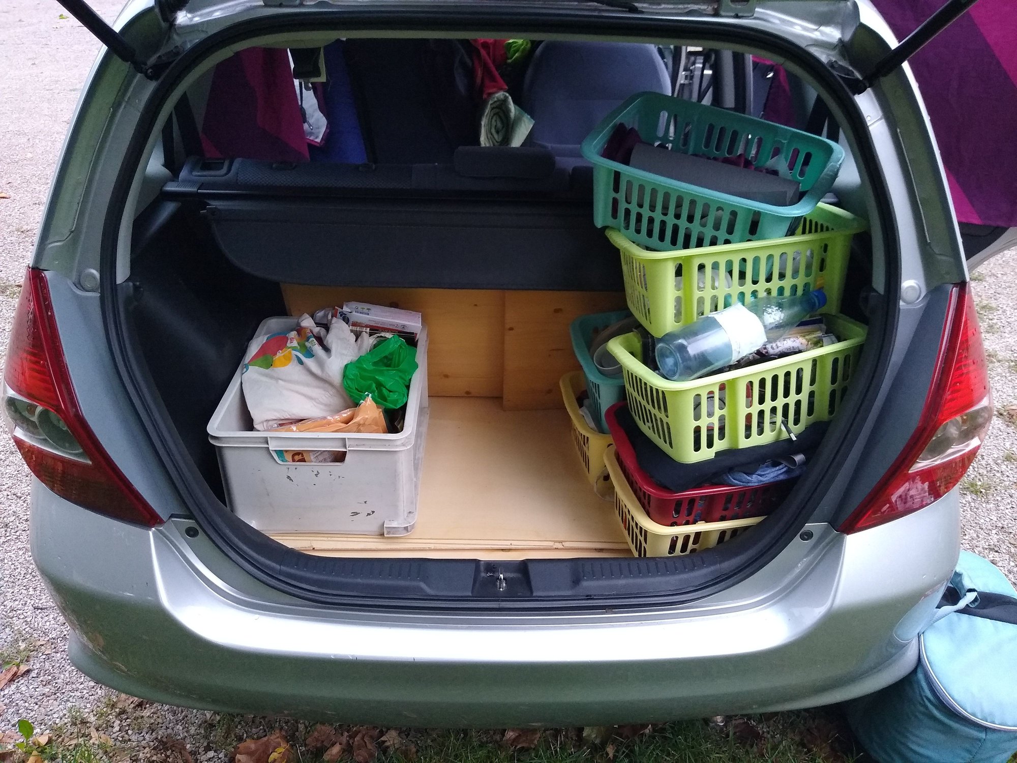

Final design
I realized I never came back and let everyone know how it works. We built it and used it on and off for a 2 week trip as well as a few weekend trips.
Pros: Folds down to almost nothing so it can stay in the car 100% of the time for a spontaneous trip, you have full use of the rest of the car and no one can see that you will be camping in it, you have plenty of space to sit up in the car while set up, super cheap and easy to make, shelf can also be used as a camping table
Cons: Although the set up is really easy for the shelf, everything has to be moved from the trunk to the shelf/front seat every night. Which makes this really good for a single night, but it became irritating when traveling for a longer period of time and we had more stuff. We also had issues with the self inflatable mattresses dying. It might be a coincidence, but it also might have been caught on the shelf and perhaps we need another method
I think we are going to keep this for spontaneous weekend trips. It is amazing to have the ability to turn it into a camper at a moments notice. But I think we might also look at building a platform for longer trips so we can have a storage area that doesn't need to be unpacked at night.
This is what it looks like set up. Essentially it is simply three pieces of wood and a few hinges. It gives us plenty of space for our feet below and we can stuff all our things on top.
It folds down really small and can stay in the trunk all the time without really taking up trunk space for other things. This is the wooden shelf and also some very thin plywood because we found that just putting it on the floor evens out the bumps which are uncomfortable to sleep on.
