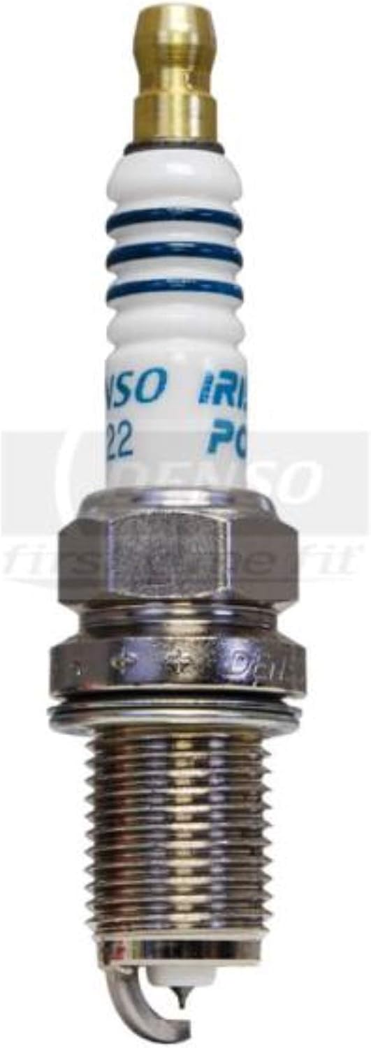

I must not be communicating this properly. You can't change to a different plug. The plugs have to reach a certain depth. The limiting factor is the amount of space cast into the spark plug hole in the cylinder head. The heads on the GK and other vehicles have more threads and, therefor, so do the spark plugs.
The spark plugs used on the GD and GE Fit's are like what you see on old 8:1 compression iron head engine. IMO, they should not have been used on a 10:1 compression, lean burning, modern aluminum head engine.
We are stuck with what we have, but proper maintenance alleviates the concern.
Old Oct 27, 2020 | 01:02 PM
GAFIT's Avatar
Posts: 4,329
From: Cleveland, GA
GD/GE style spark plug -
GK Spark plug -
