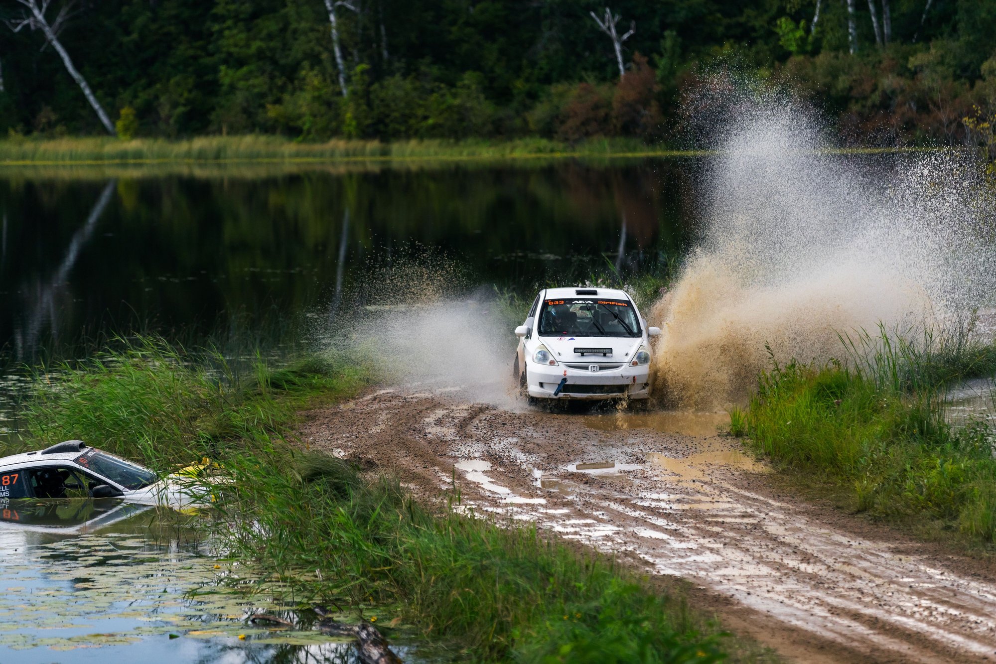

Hello all!
Over the summer of '21 and into the spring of '22 I built a 2007 Fit into a stage rally car. I raced 8 events last year and did pretty well and learned a lot. I have 2 events under my belt so far this season in the L2WD class.
The problem with the Fit.....lowest HP in the class. And I'm limited to what I can do to it and still keep in the limited 2wd class. I'm in there with Fiesta STs, BMWs and others that come stock with much higher performance.
So I'm searching for every little thing now to squeeze a bit more from this car. I just put 4.94 final drive and lightened flywheel in. Wondering if the hondata and tuning the motor is the best next step?
Appreciate any feedback! Thanks for your time!
