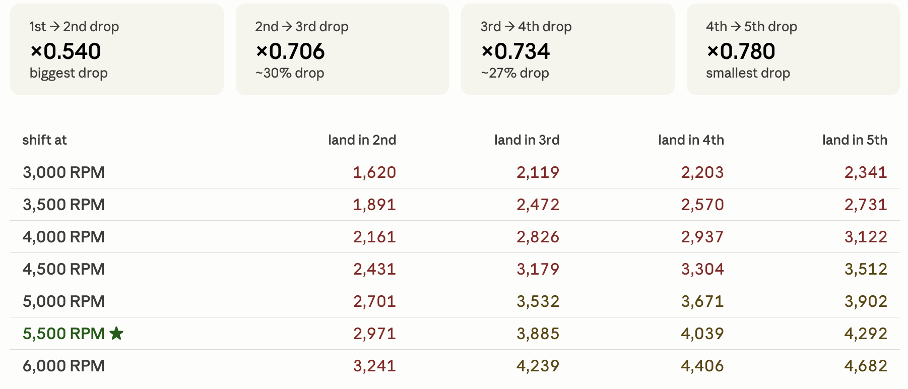

I really appreciate everyone taking the time to share their insights! For those who are shifting at 3k RPMs on street driving, do you find the engine lugs? I made a quick table with the Fit’s gear ratios (RPM₂ = RPM₁ × (Ratio₂ ÷ Ratio₁, since final drive and tire size are constants) and ignoring the brutal drop from 1st to 2nd (which is mathematically impossible to avoid) it seems shifting around 3k keeps you in a range that means you cannot access more than ~40% of the engine’s available torque and HP.
I’m genuinely interested in the mechanical happenings behind this, so I’m curious if - for this engine, based on its design - economy shifting that lands around 3k (i.e., shifts around 4-4.5k) is the right balance of kind-to-engine (not lugging on the low side, not overly wearing it on the high side) and performance. So, basically living with the engine in that 3-4.5k range for economy driving, shifting down when you’d drop below 3k and shifting up when hitting 4.5k. Once the engine oil is warmed I am sure you could shift that range up, since VTEC crossover itself isn’t until… 5,200? I think.

Again, it all comes down to what you're trying to do and where you're trying to do it.
If you're pulling away from a stop on flat ground or generally driving in a flat area, you don't need full power to accelerate at a reasonable rate and you don't have to rev the engine high before shifting to avoid lugging.
Even "lugging the engine" requires some clarification. As above, if you're on flat ground and accelerating at a reasonable rate, it's fine for the RPMs to fall down to 2000 or below when you shift -- even the small Fit engine has plenty of torque to deal with that. What causes a problem is if you shift, the RPMs fall, and then you demand immediate full power.
Think of it this way: In an A/T Fit on flattish ground you can cruise all day (and for hundreds of thousands of miles over a decade or more) at or below 2000 rpm at 55 mph. It seems unlikely the car would be designed that way if it was detrimental to the engine.
In other words, I think your idea of the proper RPM range of 3000-4500 rpm for "economy driving" is biased way high. Again, from a design perspective you have to imagine the engine + transmission combo in an economy-minded car like a Honda Fit is designed to deliver that economy in top gear (A/T or M/T) at highway speeds in the 55 - 65 mph range. That is not what you're doing. Out of curiosity, what sort of fuel efficiency have you been getting following your shift plan?
Obviously, if you're driving in a hilly area, or feel like you have to keep up with all the speeders with their V8 SUVs and trucks (in a previous post you mentioned 80-90 mph as "overtaking speed," but outside of Texas I don't know where those speeds are anywhere close to legal), you're going to have to drive the car a little harder and those driving conditions will require a trade-off between lower RPMs for efficiency and higher RPMs to maintain speed on steeper roads.
Despite what one commenter above said, revving a Fit (within reason, I'm not talking about bouncing off the rev limiter for your entire drive) won't hurt it in any appreciable way or wear it out noticeably faster assuming you do proper maintenance, but it will make a lot more noise and be a lot less efficient than it could be. It all comes down to what your priorities and needs are: noise and a (tiny bit of) fury or smoothness and efficiency.

Drew, great points - especially on the throttle response needs. I think the fun I feel from the Fit is that it’s forgiving enough of an MT to absorb some mistakes, but it doesn’t have the power-to-weight ratio to absorb being in the wrong gear at the wrong time for the wrong purpose. I.e., I found myself in 3rd on a relatively steep hill when the cars in front of me suddenly went to a stop, and foot-to-the-floor on the gas pedal could barely get me moving; too little torque at the wheels, and that’s not an experience that I think I would have been punished for (as noticeably) in a more powerful car. So, I find it a fun exercise to think “how can I keep this car responsive given the situation” as I drive throughout the day, and I’ve mapped that experience mostly on to keeping the engine in a state where (once warmed up) the car is responsive in a way that feels fun and alive when asked, aka driving around between 3k-4k RPMs in 2nd and 3rd, but to your point that’s not relevant when cruising a highway, where that would be unnecessarily inefficient.
