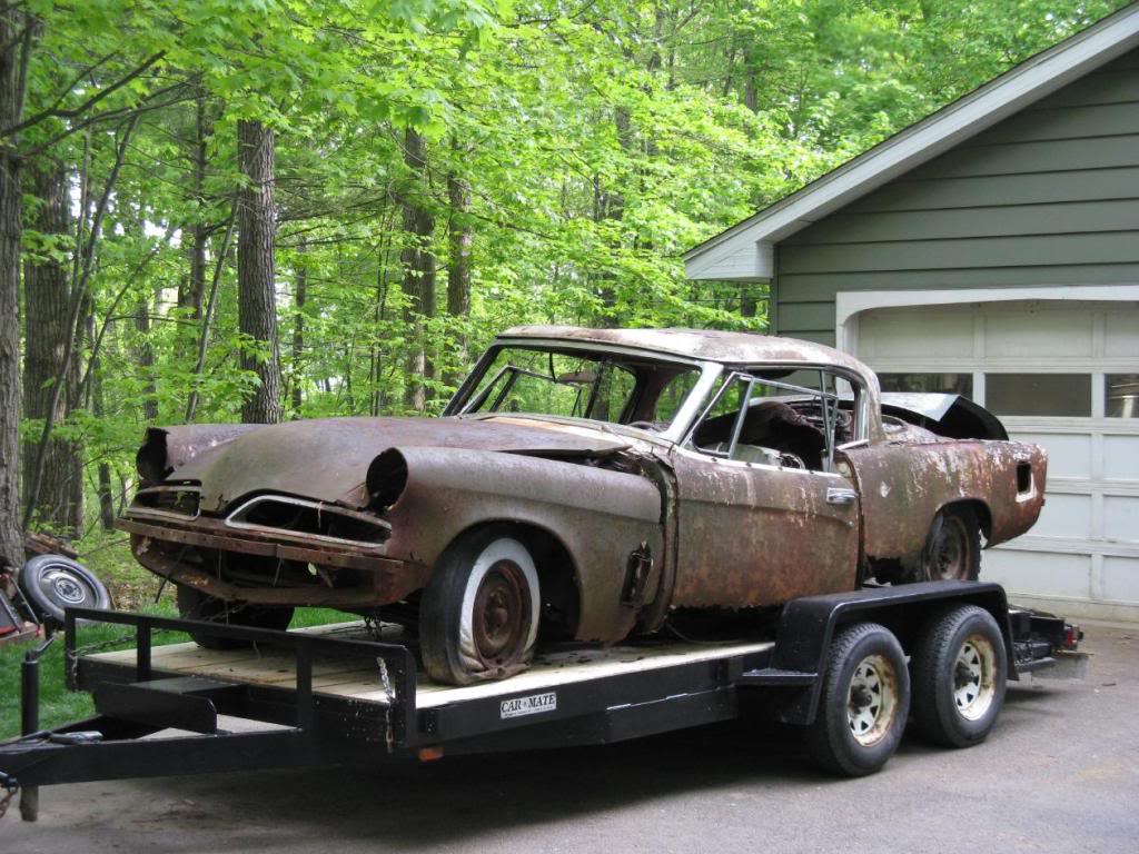

Yikes, you might have something like this in your future...not the car but the rust.
Best thing to do is wash you car when you can and limit its exposure to those corrosive agents. If you are really worried - find a beater.
Wow, a '53 Studebaker Starliner. I remember those. Even back in the '50s, Studebakers were famous for rusting out early.
