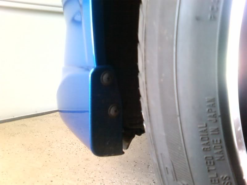

The sport's lip have parts numbers 13-16. Parts 14 and 16 are black circler tabs that keep the lip from scraping its paint shouldn't be needed. Part 15 is just some black plastic piece that wraps around the back of the lip. (The unexposed side)
But back to your main question. What do you need for to install the lip? Just the lip itself. I just checked under my sport and the lip is attached to the front bumper by two screws (per side) on the back of the bumper in fender well.

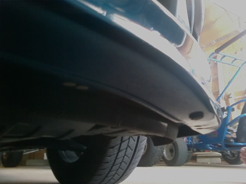

The lip seems like it may also be screwed to the front of the bumper too. I'm not 100% sure so maybe someone who had swapped lips before will chime in.
Hope this helps.
