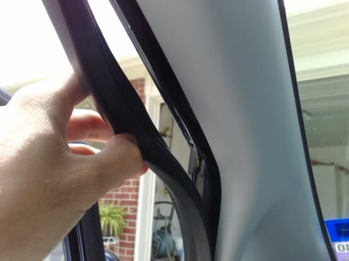

Here's the rubber trim I was talking about and spot where you can manipulate the wire out:
Just push it back in when you're done, it basically just sandwiches in there.

Your A Good Man!
Thanks for taking the time to post the pic. You didn't have to do it but you helped a guy out!
