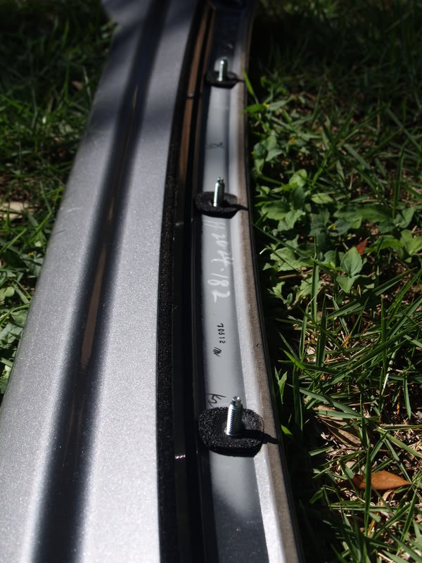

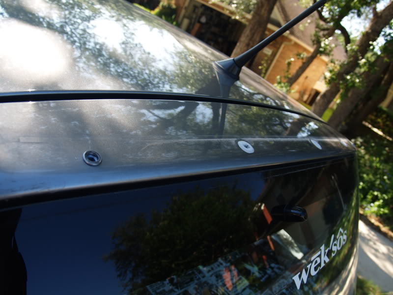

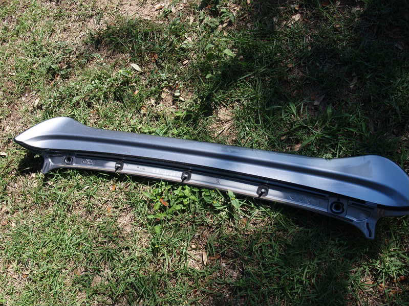

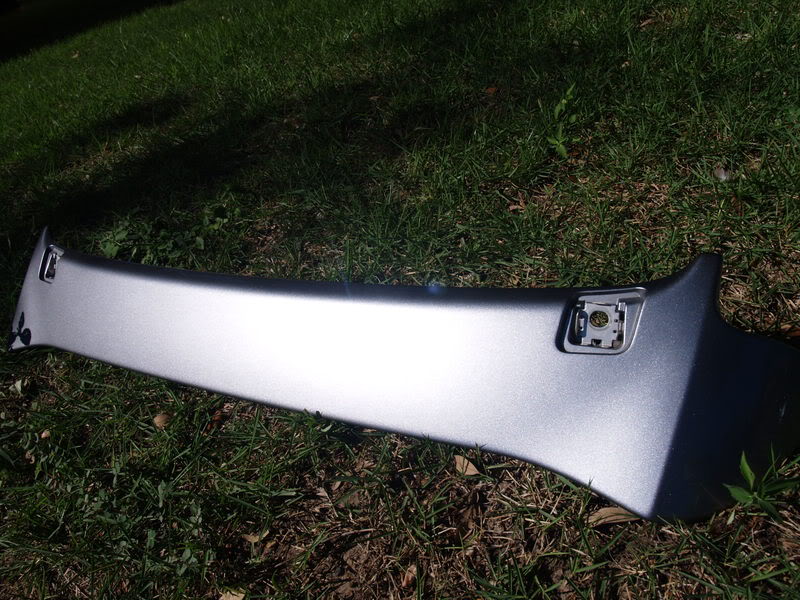

this is what it looks like off

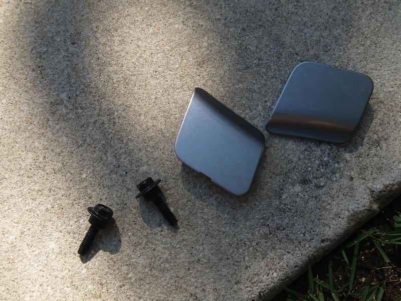

there are two 10mm bolts as stated above and once you take both off you just pull it up and it pops off
