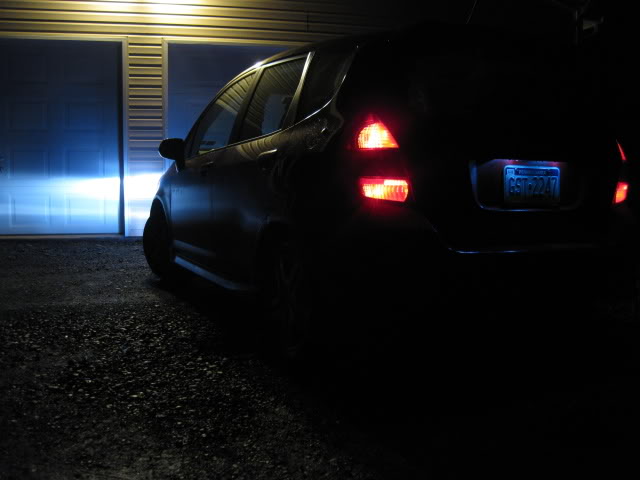

i didnt use a kit, but it is HID, just a bulb. honestly i think its a good deal compared a kit, 40 bucks for all lights with that brightness, heh, hell of a money saver. heres a pic of the output, 7000k. any car is deisgned for bulbs.. right?
the yellow light is close to 4000k, its an outdoors overhead light
