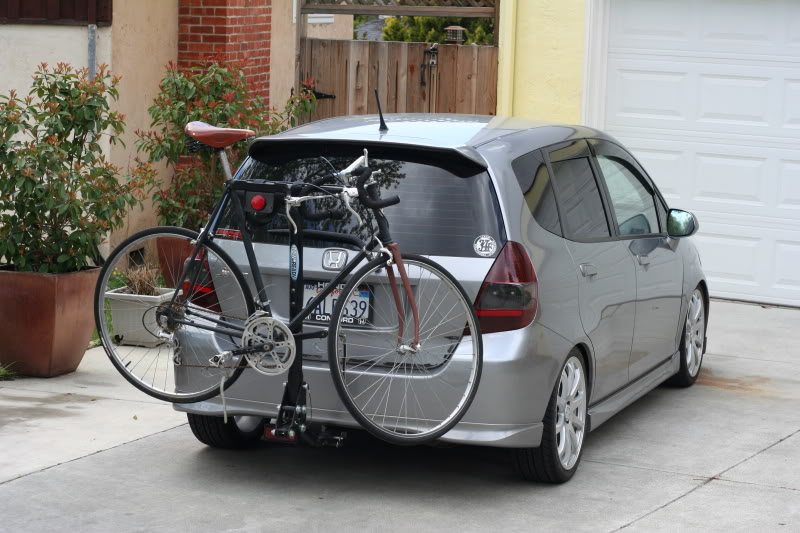

Old Apr 11, 2009 | 04:12 AM
solbrothers's Avatar
Posts: 7,343
From: Vallejo, Ca
Size:  97.3 KBworks fine for what i want it to do.
Old Apr 11, 2009 | 11:47 AM
DrPhyzx's Avatar
Posts: 118
From: Santa Cruz Mountains, CA
...works fine for what i want it to do.
Fine if you can clamp the frame. I have a bike that I simply won't do that to.
