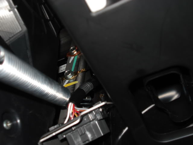

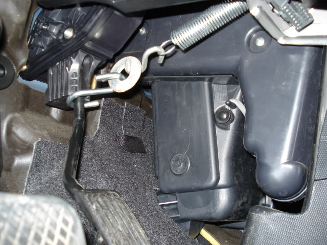

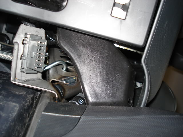

Spring was listed as a 4" L x 3/8" D x 0.072" wire. It connects to the main dash frame above and behind the OBDII port where there's nickel-sized holes punched in it.
Spring tension is a little higher than I wanted but with some spacing (hook and washer) it's usable. Initial stretch is about 3/4". Motion is smooth and it doesn't bind. I would estimate about 1.5x normal force from resting position and about 2x normal force fully depressed. I may replace the spring with something with a lesser rate but I'll see if I can adapt to this. Not like it's a big loss, the spring cost $2.69 at the hardware store and they had about a dozen this size range.
At first I just had the one hook, the pedal pressure was so great I stalled the car immediately, it took at least 30# to push it down. That was way too much!
Next task, take the hook on the pedal and coat in shrink tubing to protect the pedal's paint.
May I present the gas pedal for MEN. lol
(I suppose I should put in the disclaimer that this is a gas pedal, a device which proper operation thereof is necessary for safe operation of the vehicle, and any modification you do to its assembly is your own decision and at your own risk.)

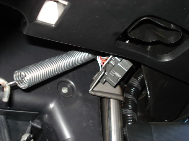

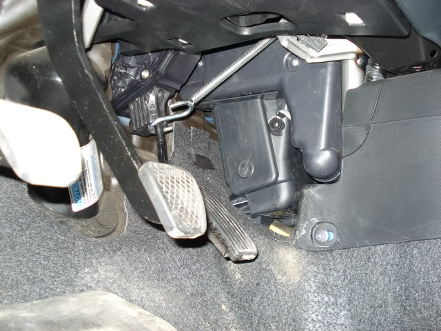

Changed out that honker of a spring for a 5" L x 3/8" D x 0.047" wire spring. Much more linear in travel. The initial feel is still a touch heavy, but it really can't be any lighter because of how little the pedal is held down to cruise. This setup, hook-to-hook, totally balances out the weight of my right foot when cruising, and it's still fairly easy to modulate. As a plus that narrow spring doesn't rub on the OBD2 harness like the other one was trying to. Also I put some shrink tubing on the pedal hook in an attempt to preserve the paint on the pedal, and it seems to be working. Instead of sliding down the backside slightly as it gets leveraged off that plastic bracket the pedal post goes into, it has traction and the whole hook angles along with the pedal without moving.

No impact on cruise control - it's drive-by-wire, so with no mechanical linkage between the pedal and throttle body it doesn't need to move the pedal to hold speed. Cruise just utilizes the actuator for the butterfly.
polaski - have you noticed any noise from the external spring? It's probably fine, but I can't help but envision the sound of a screen door opening every time you flex the throttle . . . :laugh: Regardless, a great inexpensive and simple solution.

No noise at all. It did a little bit until I did the shrink wrap trick, now there's no sliding motion at all. If you weren't crawling under the dash looking for it you wouldn't even know it was there. It's even high enough on the pedal post that you pretty much have to have your heel on the pedal to reach it with your toes, so there's no kicking it by accident. Best of all the original spring return is retained so I don't feel unsafe at all driving it. My only concern is corrosion with the zinc-plated steel parts, but at $7 a set I can afford to replace it every couple years, but then again the entire dash frame is just P&O, no plating.
