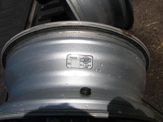

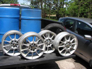

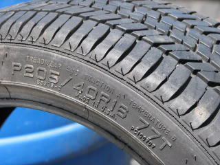

I have a set of rims that came off my Integra they are 16 inch BSA rims. I know nothing about after market rims, I assume these won't fit my 09 Fit. The numbers on the rims are 8X114.3+100, they have 8 bolt holes. Would they be worth selling separate from the Integra? (it's now is on stock wheels). They also have a set of Dunlop tires with them. Anyone have a rough idea of a fair price to ask for them? I have included 3 pictures which might be a better description.

I'll bet they are drilled 4x114 and 4x100 so the would fit the Fit. The tires are just a mite small but you could use them and wear them out. Will give you a little faster get-a-way lowering your ratio by about 2percent. The offset will probably be ok so long as you are now lowering the car. They should have some info in the casting of the wheel. Look on the back.
