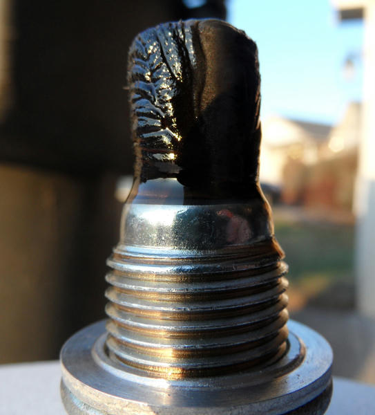

First here is the magnet on my transmission plug after 27.5k miles (90% highway):
This is driving fairly conservative. 110 miles a day on the interstate (occasional get up and go )

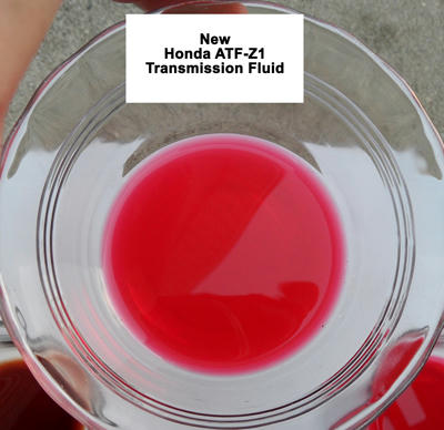

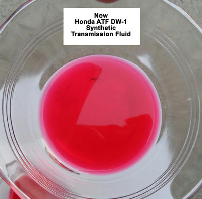

Here is a comparison of transmission fluids
My used ATF Z-1, New ATF Z-1, and the New ATF DW-1 Synthetic:
Close up of the fluids:
Paper comparison:

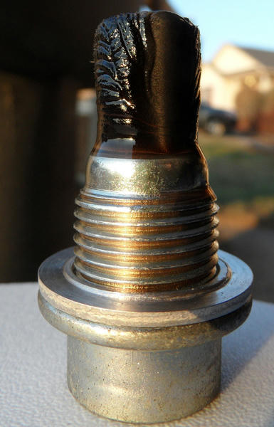

My last oil change 7K miles ago, I added a magnetic oil drain plug.
Here is the plug of the recent oil change I did at the same time I did the transmission fluid.
Not too bad

As for the new synthetic DW-1, I will be tickled if it has a resemblance of redness to it after 20-25k miles. Then I know that it is engineered a bit better.

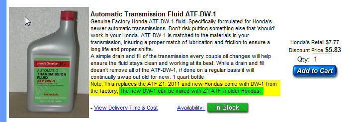

Was going to get the z1 since I wasn't even aware of the DW-1.
Is it 100% confirmed yet that it's backward compatible with the z1?

Please post the mpg gain after you get some miles on it. I am surprised how much metal/sludge was on the plug.
Yes - This is from Handa Accessories aka Carmichael Honda - NorCal

Good job on more "data points" for transmission fluid color at XX miles
I really hope the new fluid holds up better than the older Z-1.
I am going to take samples every 5K miles from my transmission to see the state of change as I rack up more miles.
