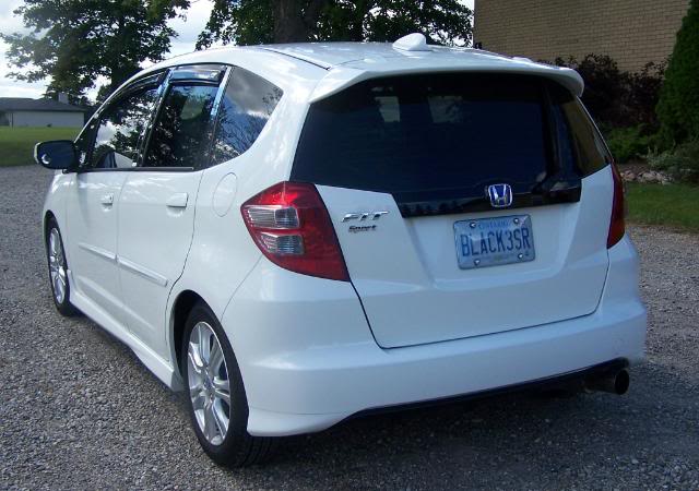

I paid $349 CDN 2 years ago for professional job. They do tint for the local Honda dealership. Super job. Yes expensive but worth it.
This year I took my new Caravan in for front windows and windshield. Debit machine was not working so instead of $180 got it done for $125 cash
My tint
