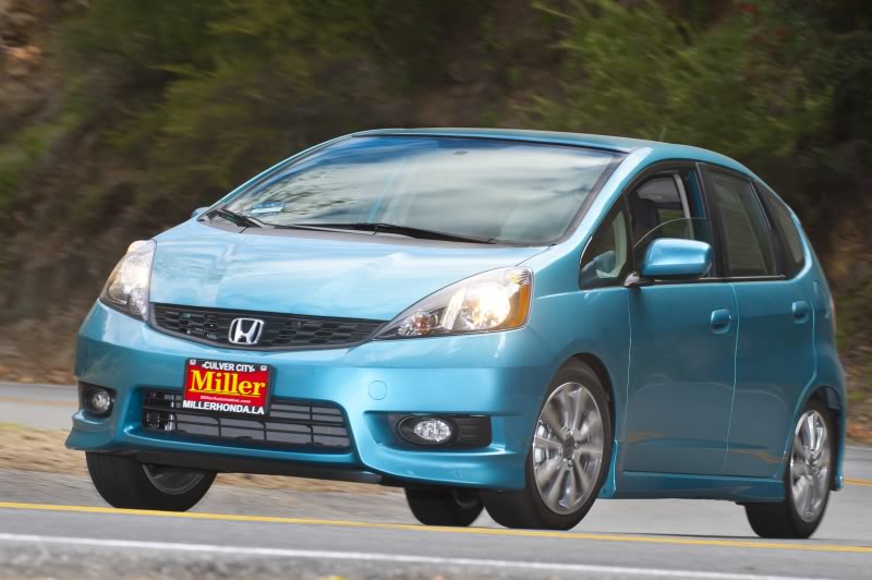

I've pushed my 2012 Sport to the limit of the stock suspension/tires
and all I got was body roll and the tires gave up their grip but that was it.
I love how this little car handles in the canyons and I plan to keep the stock suspension and not even lower it at all.
I will upgrade the wheels and tires only and maintain my comfy ride if you can call it that
