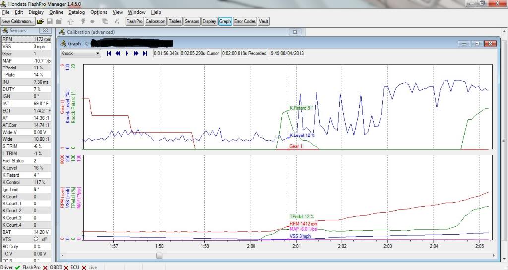

And ya, thats a bit of a no-no in my opinion at least. That's the sort of detail provided in my briefs with a new tune to an end-user. I actually like that ours are so sensitive.. for when we need them to be like an FI application.
These are the stock HiCam sensitivity settings:
This is a test run on 93oct E0, sensor readout on the left to provide the vitals.. and here we are just barely rolling into the throttle then BAM pulls 9* advance just for the f*ck of it.
This was while operating in an entirely unmodified part of the IgnLow map. That's quite a torque penalty.
Just food for thought, everyone.
