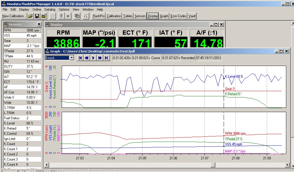

Yup, this is generally the wrong group to discuss anything more complicated than plasti-chromed Autozone hood louvres with..
Who cares if we have repeatable results at the track, or even simpler than that: I can still log actual knock counts on 93oct in regular stop/go trafic because of our very high dynamic CR and then share the screenshots, only to be met with closed eyes and covered ears.
We have non-tuners who haven't even had any experience with other fuels let alone other grades of the same fuel.. but will post non-technical advertisements and magazine articles written by other laymen that agree with them.
It's faith based and not factual. It requires parsing of words and semantic games. You will see word abuse, particularly the words "designed" or "required."
It's entirely disingenous because for whatever reason they have a lot of emotion invested in this issue, that they have wasted days of their lives slamming their booger-hooks against cheeto encrusted keyboards because they have nothing else better to do with their time. To admit error would be to acknowledge how sad this is.
The facts are: it is only because of our knock sensor and the logic interpreting it that is used to control adaptive timing and fuel schemes that you can even get away with 87 in the first place. The language in the manuals actually state:
Unleaded gasoline, pump octane number 87 or higher
Use of a lower octane gasoline can cause a persistent, heavy metallic knocking noise that can lead to engine damage.
Taken directly from Page 186 in the USDM 2012 Honda Fit Owner's manual, viewable here:
http://techinfo.honda.com/rjanisis/p.../TK61212OM.pdf
What you need to take away from this is that 87 oct fuel is the bare minimum the ECU is capable of providing a safety margin for.
That is not my interpretation, they specifically use the phrase "or higher." If it was "designed" for 87 it would simply say so.
Our Dynamic Compression Ratio is the reason why. Not only do we start with 10.4:1CR static, but we have a Cam and VTEC system design to keep cylinder pressure high throughout the rev range.
We have data, we have shared it:
See that? That green Line "K. Retard 5*?" See how it's sustained event for nearly 5 full seconds, while cruising in 3rd gear @ 25% throttle? That was on 93 oct in my car on a nice cool day!
We have the backing of the Manufacturer and the laws of physics.
What "we" don't have are controlled studies stating anything above 87octane in stock cars improves performance where the manufacturer does not recommend or require higher than 87 octane.
"We" don't have anything from an enthusiast magazine stating this either.
"We" do have anecdotes and evidence from you and others where other variables (modifications) are not controlled, still without any evidence to support improved performance, either fuel consumption or power.
You have provided nothing but inferred performance gains with a bunch of silly posturing.
No, if it was designed for higher than 87 octane it would state higher octane is "recommended or required" as Honda/Acura does with other models.
