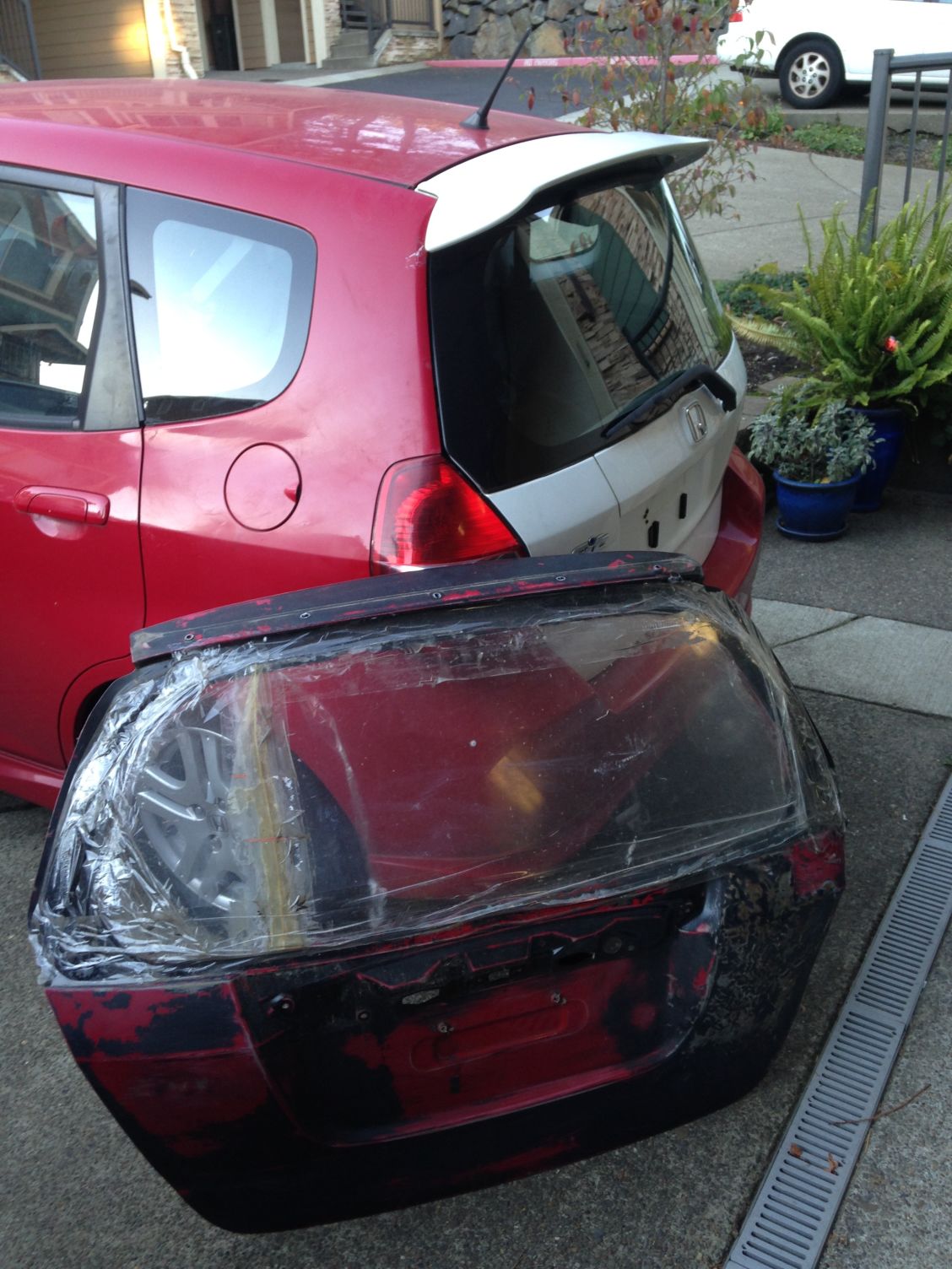

The hatch that was on the machine and the new white one on the car..
I stripped all the good parts off the hatch, I figure I can eBay them to scrounge back some of the hatch replacement cost.
FYI don't be afraid to order a hatch if needed, the shipping should not be to bad, it turns out this is likely the lightest hatch ever put on a car. I can lift the whole hatch with one hand off the car ,,, had my wife hold it while I put the bolts in..
Once i get the exterior kinda under control I'll probably take it to a pro body detailer and have it blocked and waxed.
Attached Thumbnails My &quot;CHEAP&quot; fit. The log..-80-img_2526_717d4c74507aafa48e8e452d4b313594487d7a6f.jpg

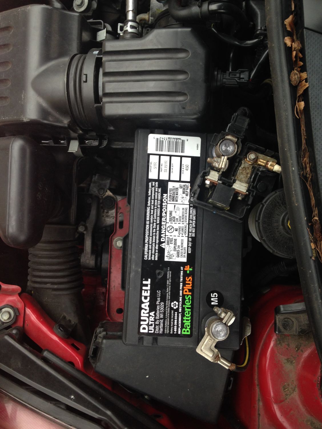

Well fun this week, headed to work and the Fit wouldn't start. Jumped it and went to a local store and checked and sure enough the battery had died. They didn't have one in stock.. arg so I went on in to work (It was barely starting but getting it done.. ) That night the bug wouldn't crank again so this morning I went to Batteries plus and bought a new battery, I did not use the stock itty bitty SLI151R, went with the SLI51R. My motorcycle has a bigger battery.. Instead I put in a battery that just barely fit in the tray. its 450 instead of 325 CCA. Man does that little car start up sweet now. I'll get a pic of it up later.. Battery was 99 bucks with a carry out discount and my old battery as the core. The Smaller exact fit is 35 bucks more expensive. I still have some adjustment to do to tidy up how its installed but happy so far.
Attached Thumbnails My &quot;CHEAP&quot; fit. The log..-80-img_2664_fa8b70b64ccb7c922993013dc2af91303519a9c1.jpg

Thanks I'm still chasing the mystery short, can't find a good 2007 wiring diagram, using the word "FIT" to name a car should be grounds for execution. Kills web searching.. >
The up side is the 51R battery sat for 2 weeks and ht car started like a champ!
