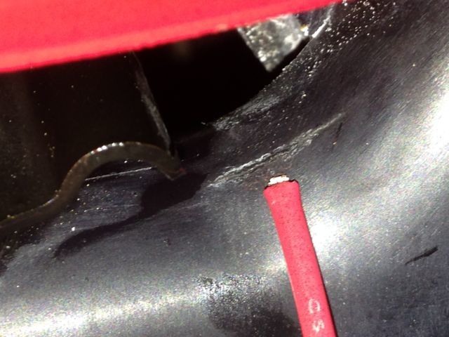

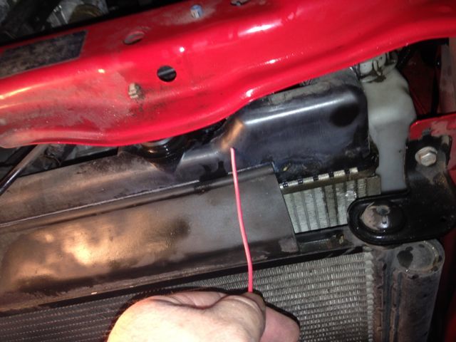

Car has had an issue losing coolant, pulled the front bumper to start fixing the cosmetic stuff up and tangle with that.. Well its got a crack in the plastic tank. so ordered a new radiator from Rock auto with hoses and high flow thermostat for right at 125 bucks. shipped. Crack in the middle of the tank on the side where the radiator hose and filler attach. Would not leak till the car was at full temp. nice little spray once the system came up to pressure.

Paid 400 to have a shop swap the radiator out for me and pressure test the system.
Two days later,,, Well it just got more expensive.
Blown head gasket. $1200 ish at a shop or $300 and bloody knuckles if I do it myself.
Also have the option of just buying a used engine and swapping the long block ($300 to $1000). Got some thinking to do yet..
The blown gasket was pressurizing the cooling system and blowing the coolant out.
Then it overheated .. So if your losing coolant and don't find a real leak, but the overflow bottle is staying full,, well the next step is a pressure leak down test on each cylinder at TDC with the radiator full and the cap off..
