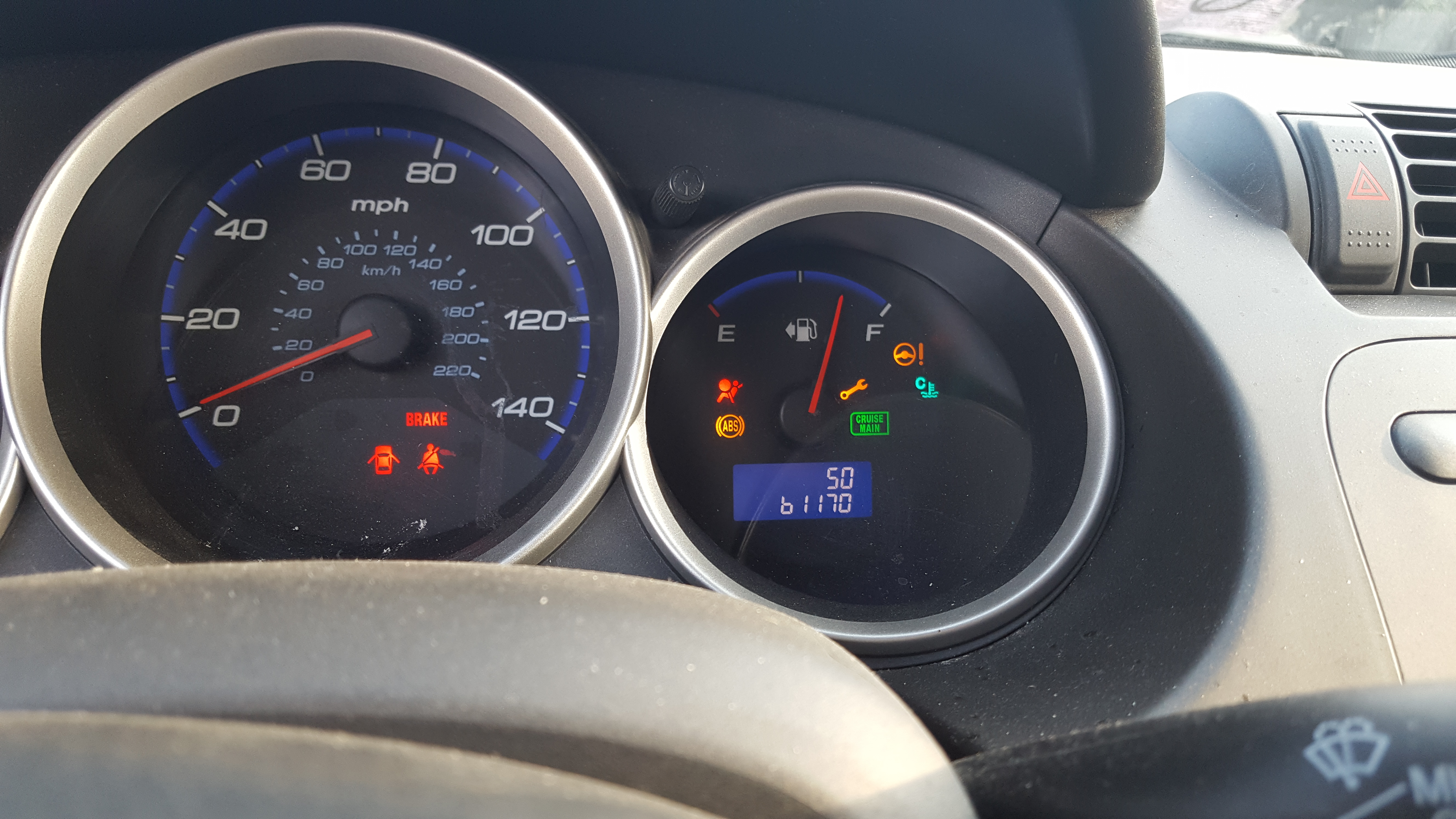

Thanks I tried this awhile back. ABS doesn't flash, only the Electric Power Steering. Beeps two longs and two shorts. No idea what this means but I don't have any issues with the power steering.
Some odd numbers come up on the mileage indicator but no clue what those mean either. They don't seem to correlate with any ABS codes.
